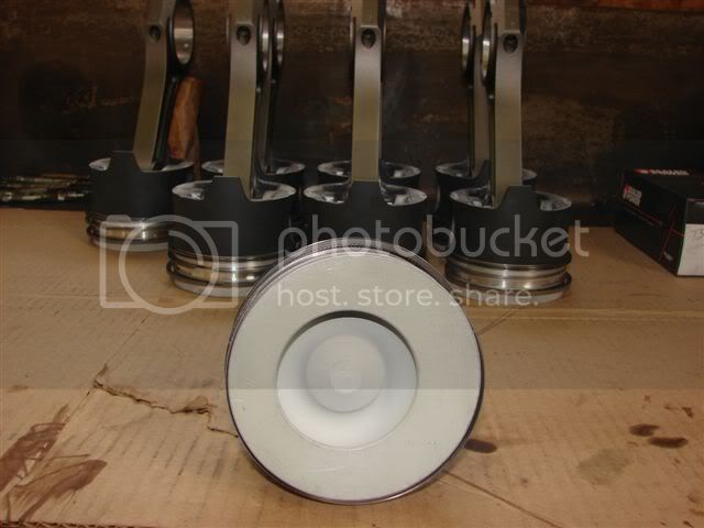

Can't just "add" a girdle. Needs to be line bored and rotating assembly needs to be balanced. Fill will be added. So complete tear down is happening. All clearances and tolerances done. Pistons are already done. Just not coated
It's almost a shame to bury something so sexy inside one engine...
That is sexy haha. Mine are just delipped and radiused. 15.5:1. Coating just added security for heat and crack preventative correct?

Well doesn't look like I'm going to RRE. BUT everything will be done to the max. Having Carson build my motor again. Stage 2 cam, relief cuts in pistons, coated pistons, Carson is porting heads more. Twin terminator pumps and changing injectors to 450/400. Fire ringed heads and he will hot retorque for me on the stand. Ati dampener, precision flex plate, girdle and aluminum valve covers came in. Dropping everything off probably next weekend.
