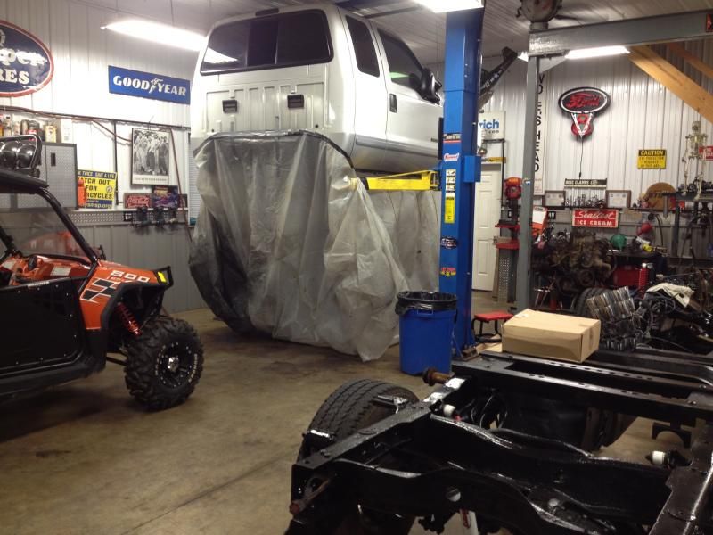

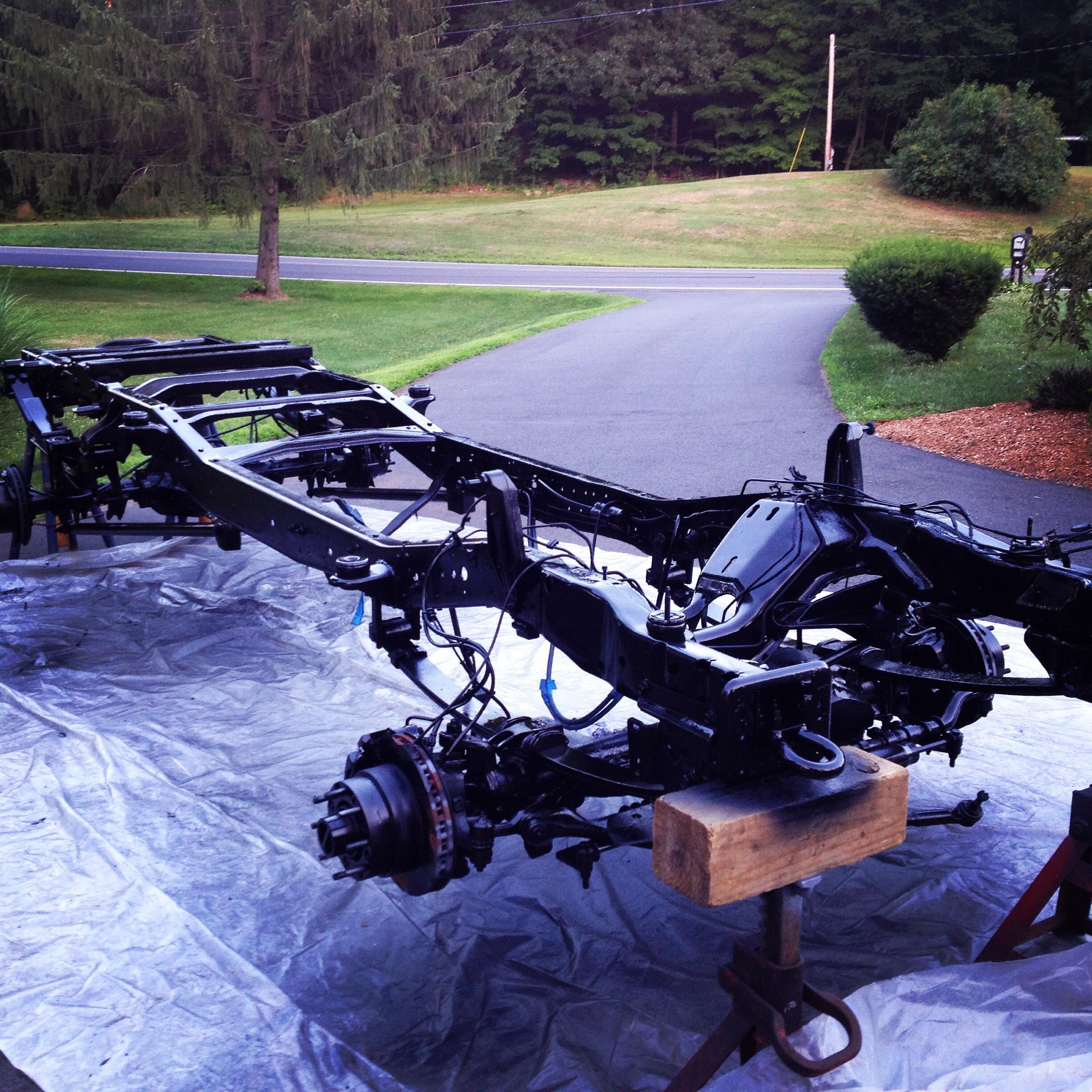

Power wash. Scaled frame. Then flapper disc. Wire wheel. Power wash. Must on thinner and wipe down. Used 1 gallon of Majic diamond hard truck tractor auto primer, and the same brand but in gloss black. Reduces with water. 5-10% by volume if being sprayed. Regulated at 40psi, 1.4 tip maxed out.

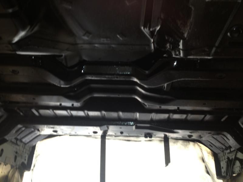

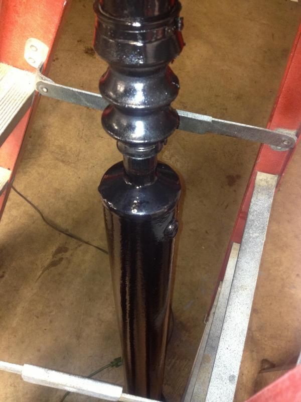

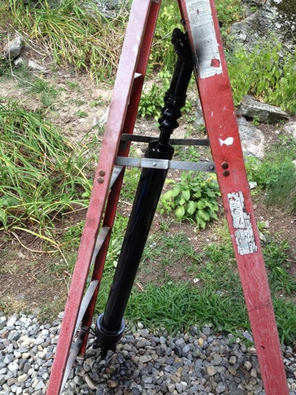

Did under my cab and driveshafts Monday. Under cab was scaled and sanded, POR15, then 2 coats of ford light grey, 2 coats clear. Driveshaft was sanded smooth, 2 coats of POR15, 2 coats clear

Then I also replaced upper and lower ball joints on each side, inner axle seals, steering box, all new shocks and steering stabilizer, reloomed and taped entire chassis harness, rerouted fuel lines, waiting on pan from Cory, will be here today.
