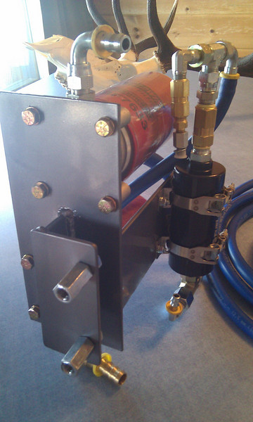

From a while ago, final filter is a donaldson now, but that's how my filters are.

What I'd like to see you do....
Hit up Jake for his fuel system bracket....he might sell you one separate from his tank to engine system. It's a pretty nifty deal...it'll mount up to the left rear center console bolt and the right rear drivers seat bolt using some couplers....tucks right up behind the transfer case on EC/SB trucks.
Plumb your sump :ford: right into a filter block sporting a Baldwin BF1252. Good pre pump filter and water separator.

If you don't like the Irate bracket, this looks pretty slick, clean and simple too.
