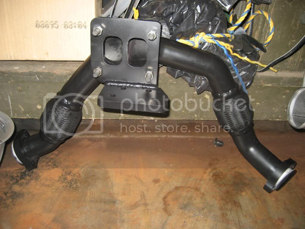

It's the uppies. Car Quest discontinued the donuts we used to get from them, found another part though. Felpro # is 8194. $1.99 each.
With the H2E it should be a lot easier than the stock ones.

I assume you have the Hypermax kit. Did anyone ever make bellowed up pipes for that kit. I wonder if Irate couldn't whip some up for those who still use/want the T4i turbo kits.
Now that I think about it some more, Carson has a T4i kit with bellowed uppipes. I wonder if they would fit a Hypermax kit.

Yeah, I have the Hypermax kit. Been wondering about bellowed uppies for it. If I had a motor on the ground, I would think about pulling my turbo off and mounting it on the motor so I could fab up a set myself.
