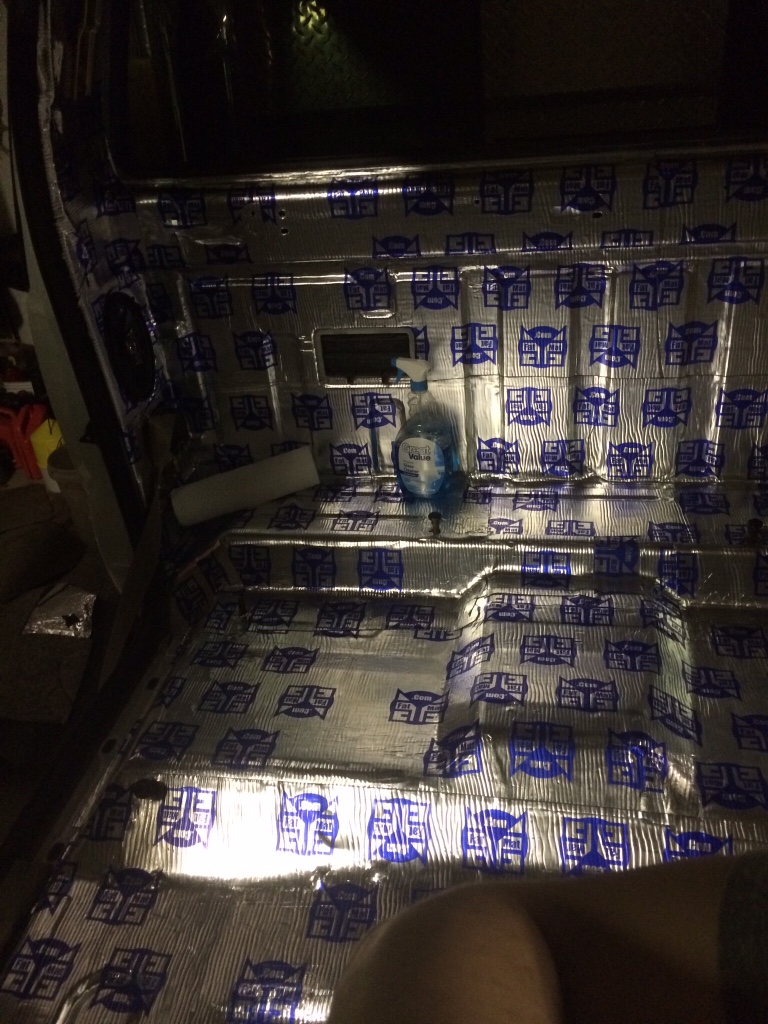

I only did the front portion of what you see and it made a huge difference felt like it dropped it at least 10 decibels this took 6 rolls($15 an roll) but i put it on overlapping have of each piece to kill sound.

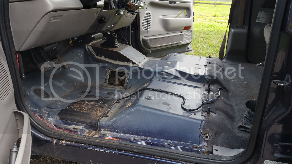

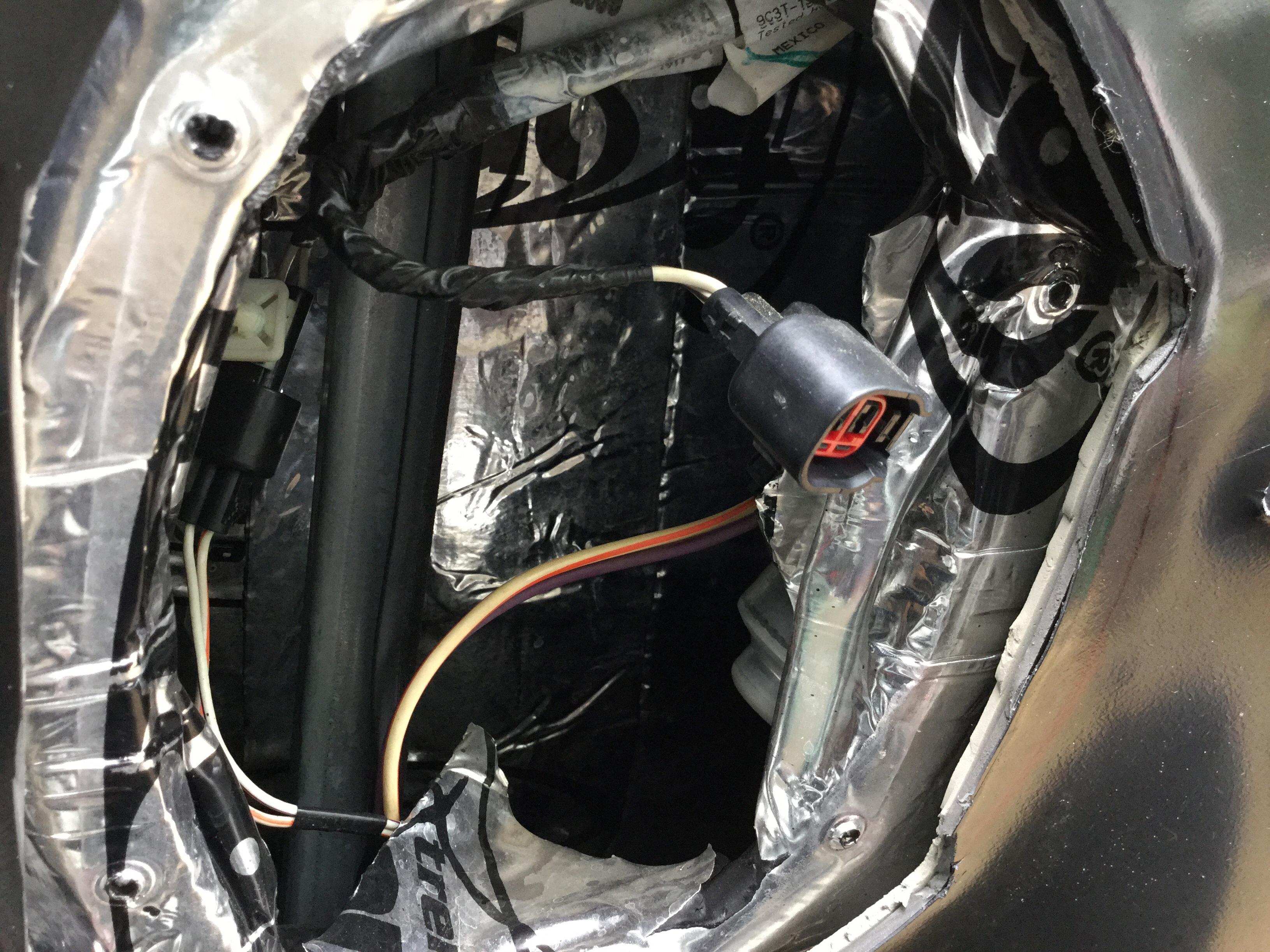

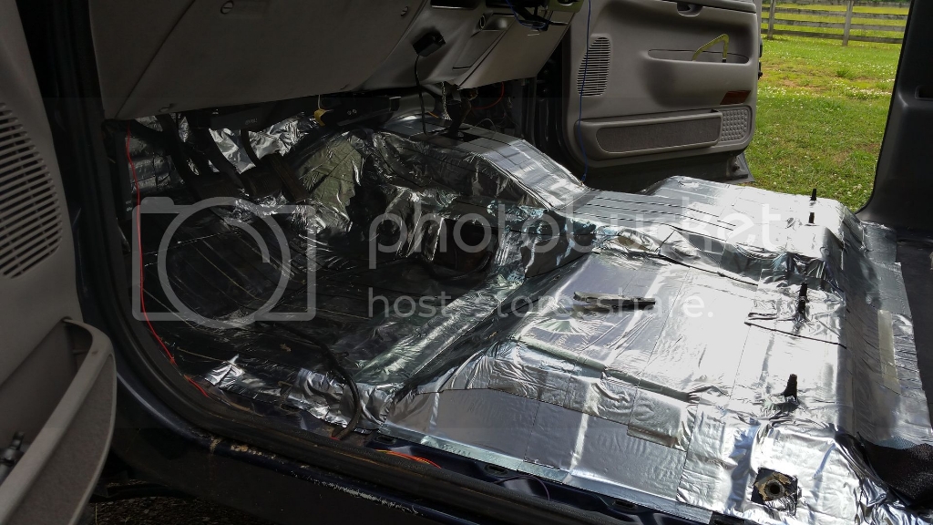

Does doing this stop sound, no. It doesn't insulate/keep sound out at all. It does eliminate a ton of vibration and that alone is quite a bit of noise in these older trucks. I used fatmat and it looked like my truck interior exploded all over the garage, but It helped a decent amount. We can have a conversation, lugging the motor up a hill, with dual 8" pipes behind us. In this case covering that rear wall helped a ton. Also with the sub behind the rear center console I noticed it sounds deeper now as well.
It does help some on these older trucks, but by no means does it cancel sound.

I'd do it again on an old truck. I'd probably do more than I did. I ordered 200sq ft and I've still got enough left over to do the doors. I'd definitely get a spare roller tool because the one the supplied me with was junk and didn't make it half way through.
