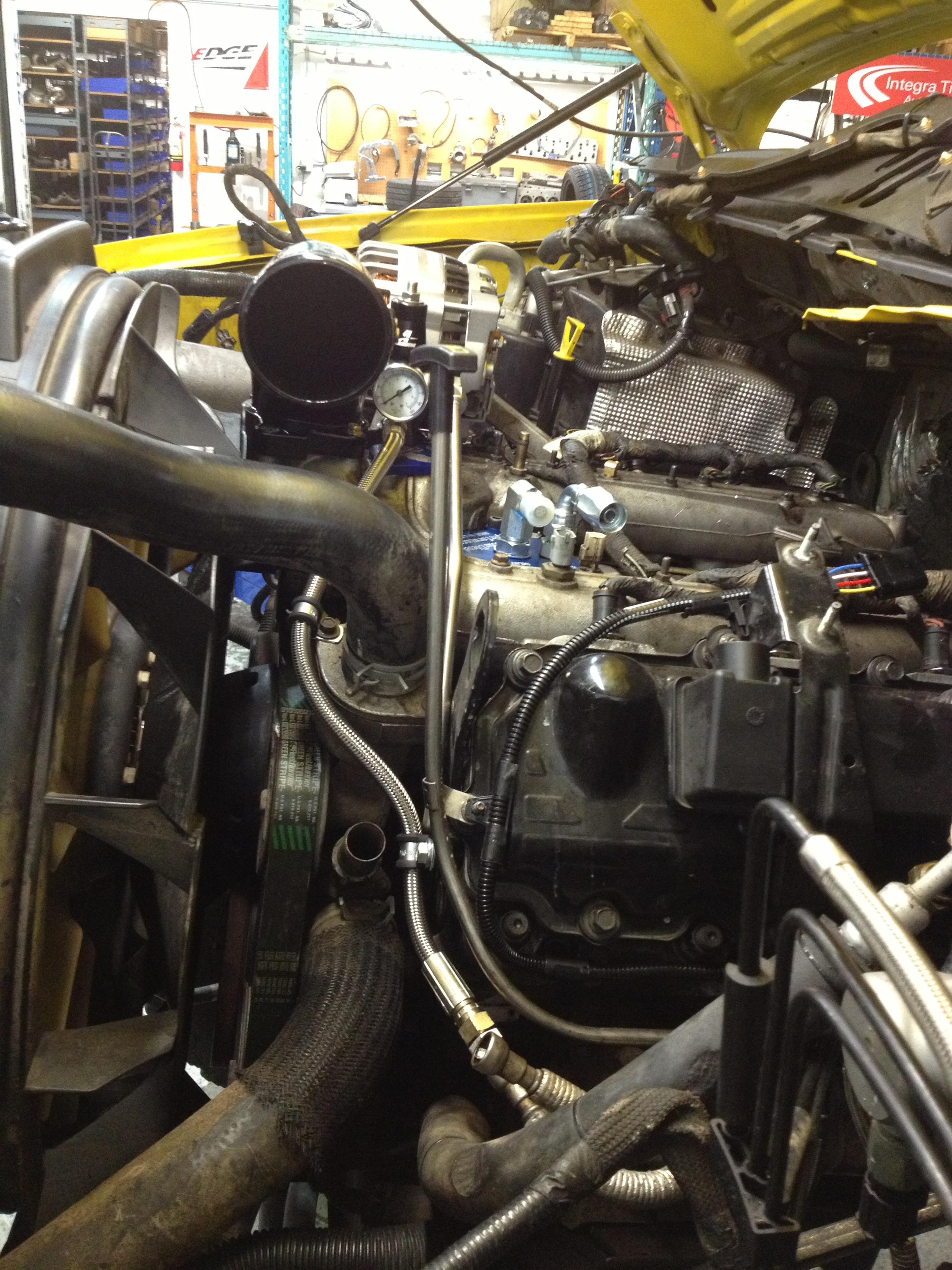

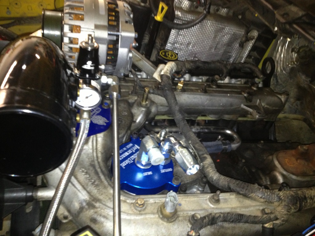

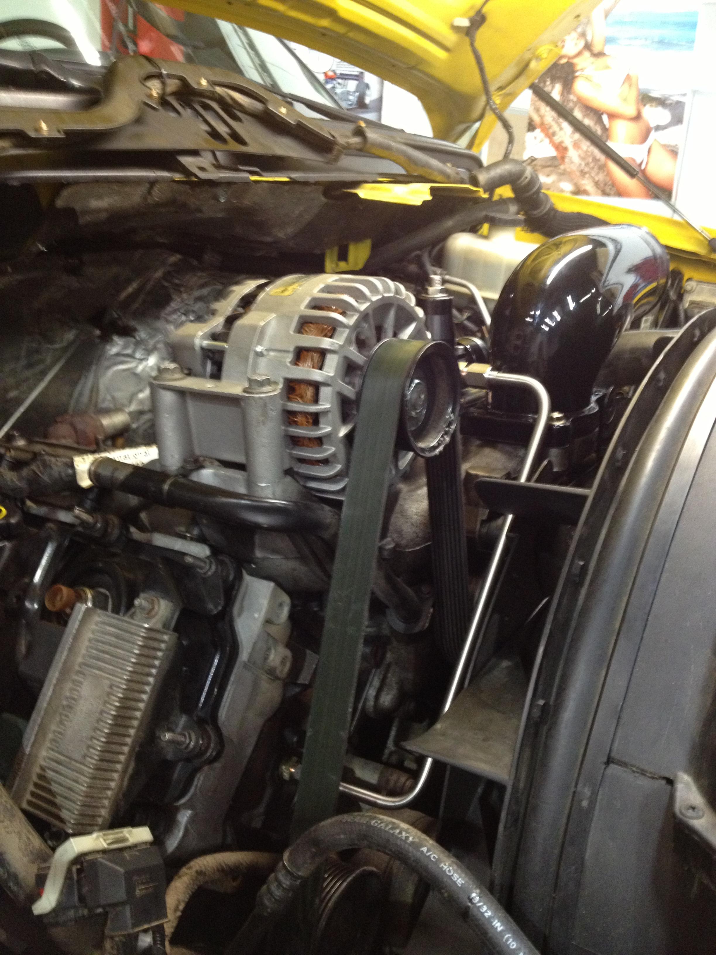

Thought id share some pics of my compounds build not greatest pics but. With some help from JJ @ Dozers we used some of his parts from his reg return but thought we would try something different and feed the back of the heads and exit out the front please dont flame we are just trying this cleans up the engine alot! Doing a remote oil filter will be posting more on that as it goes. We had some old Fass systems at the shop that where old stock so to save a couple bucks. BIG BIG BIG THANKS to PDR Diesel here in BC for taking on the build:clapping:

Who's rr are you using? Let us know how feeding the back of the heads works out!! I like the idea. Good luck on yur build, looks good so far!!

feeding the rear and returning the front is no different than feeding the front and returning the rears. I feed the rear of the heads and return off the front on my truck.

Made most of it at the shop. Got a kit from dozers decided to do something else use a little of his kit made the rest of it.

The front of the head is actually quite a bit higher than the back, since its a regulated return its irrelevant but for someone not flowing through it makes it a pain to prime.

I got mine flowing through the front of the heads first and out the back because I didn't want any added heat from the exhaust up pipes added to the fuel before it gets to the cylinders.
Since it passes out the back of the heads, and then to the return, I added a fuel cooler to mine as well.

Should be Justin @ PDR diesel said he was using -12 ill be going back To the shop Monday and will have more info.

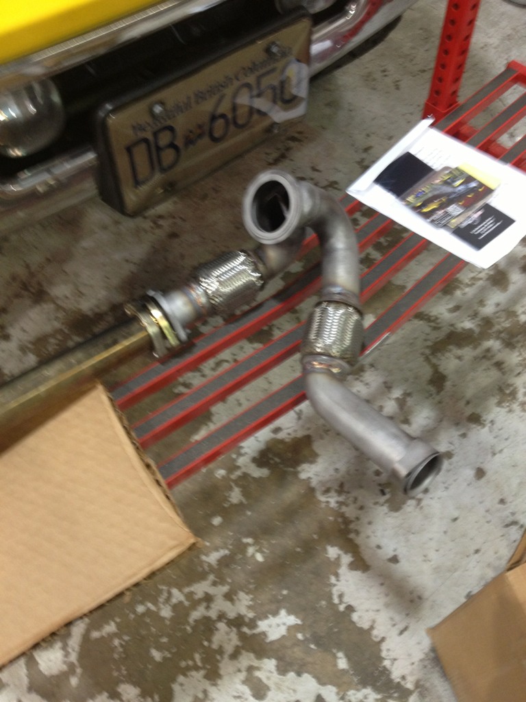

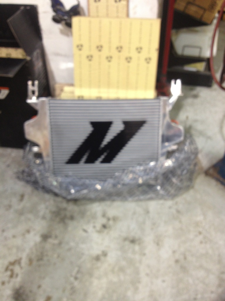

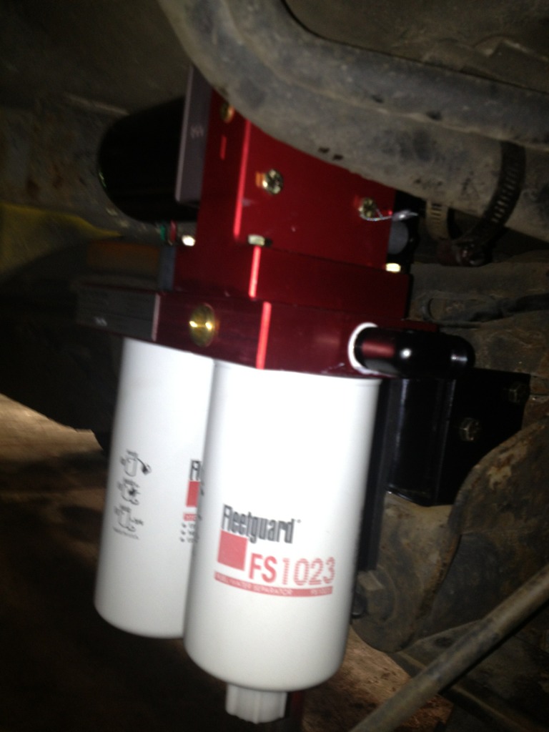

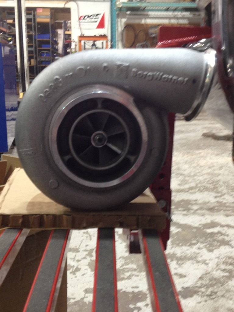

Was like Christmas today for me!
Oil cooler cover for filter relocation
Fass fuel pump
PDR updated up pipes
New intercooler

i feed from the rear and return from the front always. makes for a nice tight clean install
