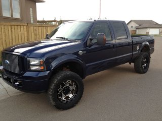

Recieved so far...
Z max intake manifold and steed exhaust manifold from Elite. (Thanks J.D.) packaging was amazing! Enough bubble wrap and popcorn crap I was beginning to wonder if anything was in the box! No rubber maid tote included? Lol
Custom up pipes from Matt at cutting Edge! Thanks for the quick turnaround
Just waiting on USPS for the Absolute pipe and Elbow, then everything will be ready for Shawn when he gets back from Ennis!
