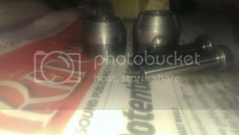

I tore down a BD code injector to compare the internals to the large split shots. As you can see the shorter single shot BD barrel on the left and taller split shot barrel on the right.

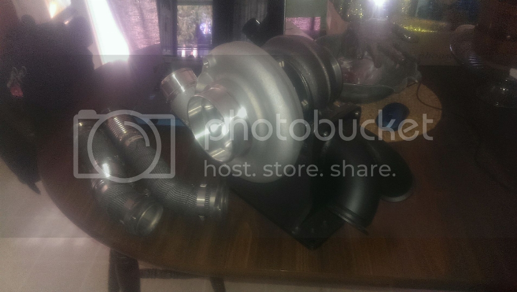

I have had no downtime long enough to fabricate a T4 mount for my 369 so I decided to just buy one. I will still have to modifiy my down pipe and I should have this S369sxe spinning soon.

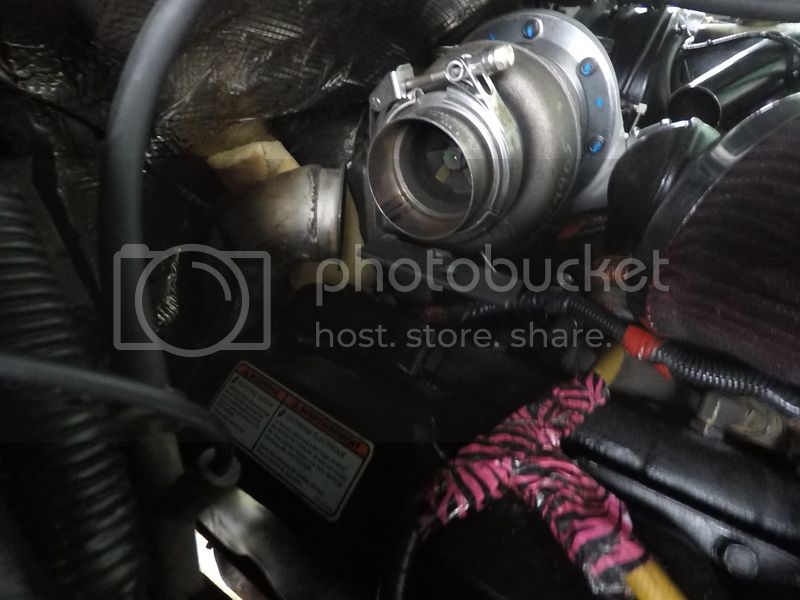

Almost done with the install. Still need to modify the spider. Later I will upgrade to larger plenums. Also modify the down pipe and a few other small things.

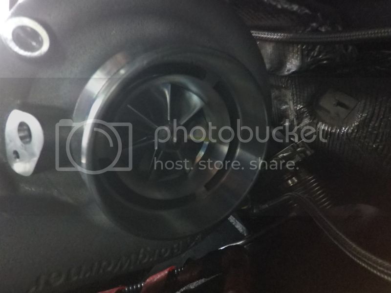

Picked up the GoPro Hero5 black this morning so I tested it out with the first fire off of the S369. Just need to modify the down pipe, modify spider, and clearance a few small things. Just testing the mount for leaks.
https://youtu.be/L7OqtHztCAs

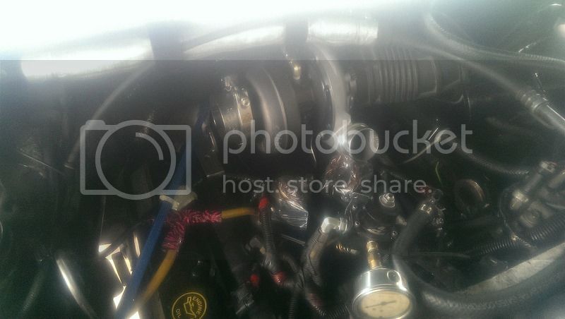

I finished modification to rear lifting hook to allow clearance for a down pipe. I am in the process of removing down pipe to be cut up and modified. Still have to modify intake spider to compressor outlet. Also connect compressor inlet to existing feed pipe from intercooler. And a small diesel leak that is likely the mechanical pump or copper washer not sure yet.
