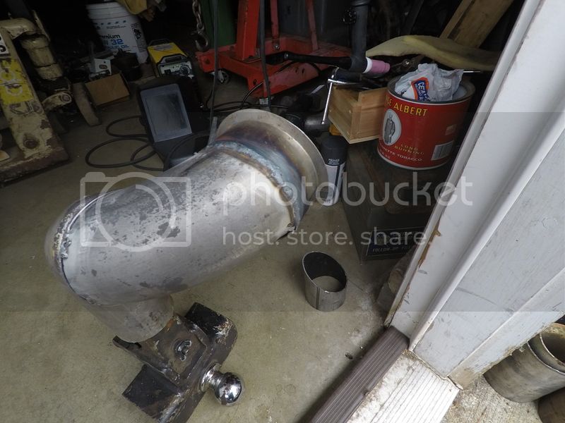

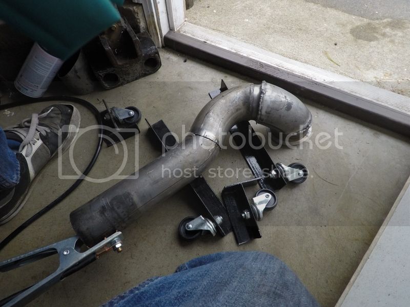

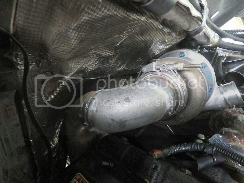

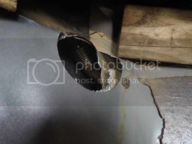

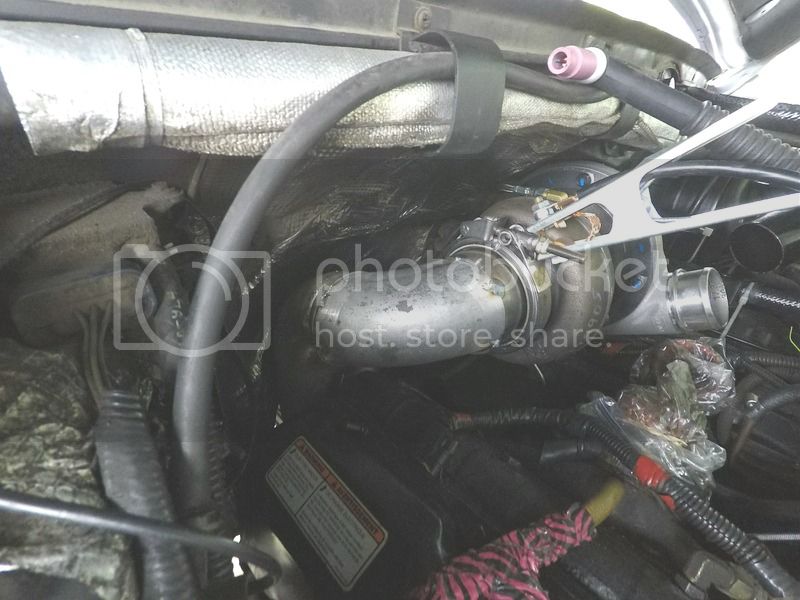

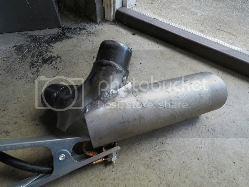

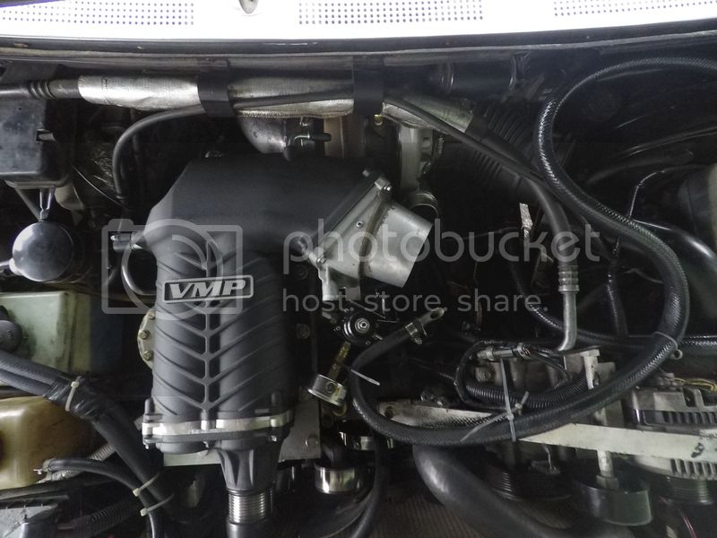

I finished the downpipe and yes I can. It's only a 3" down pipe I may try to build a larger 3.5" or 4" down pipe later. I chopped up and reused the 3" down pipe for the stock turbo. I reused the slip fit design. I fought getting the downpipe setup as it's hard to cut and align and tack a down pipe with the engine in place. I looked to try and massage the firewall without beating it to death. I planned to anchor the wall and use a come along to pull the firewall. After checking the firewall and finding a huge crack from when the previous owner beat on the firewall. I then pulled out the 4" hole saw and punch a small hole to clearance the pipe. Now the down pipe rotates and drops right in.
I need to finish connecting down pipe to exhaust and I started on the intake spider and reinstalled the blower.

Naw I like the blower. I still have a lot to upgrade after all this. Like larger plenums, rerouting intake plumbing to intercool after stages, studs & springs etc, fuel system. Started on the spider to get it back on the road.

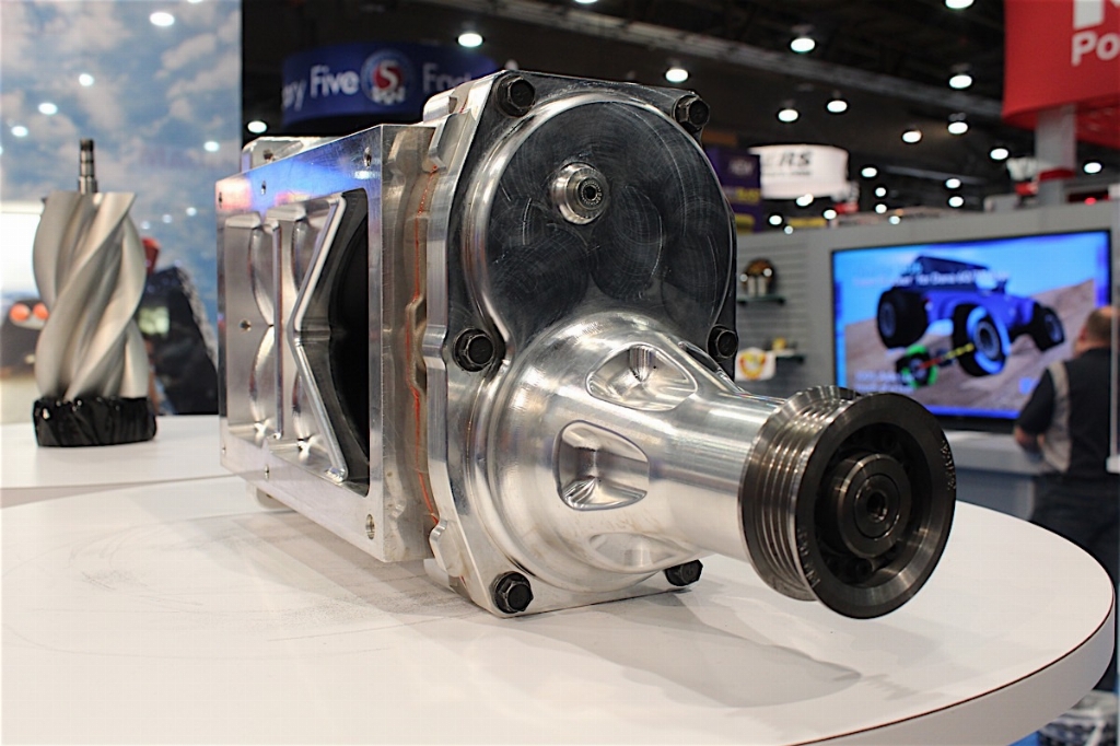

I had been unable to spool the S369 since it has been installed. The gauge was only registering what the blower was putting out (10 psi) and I never heard the bypass open like the stock turbo would. I figured it's likely the 1.0 housing and a tune that has limited PW. After playing around in the factory calibration I found that the turbo spools crazy fast as I easily saw over 25psi and you can hear it when the bypass opens up. After playing with tuning I found that the issue was too far advanced timing. My base tune with the stock SOI map thrown in spools the turbo with ease. I need to light the fire under my heals and install more fuel pump and studs might be a good idea this next year. Also not that it's necessary but when it releases I will likely upgrade to Eatons new rotor pack from my 2300 to the 2650. It was shown off at Sema. Once VMP releases a Bolt on unit more displacement with higher efficiency is the name of the game.
Some specs on the new rotor unit
Vehicle
Supercharger Products
TVS® R2650 Supercharger
2650 Supercharger
The all-new Eaton TVS 2650 is the next step in the evolution of the popular TVS platform. The high twist, 4-lobe rotor design is 15% larger than the TVS2300 and features several improvements to maximize efficiency and performance at upper RPMs.
FeaturesTesting & ValidationFAQInquiries
170 degree twist (vs. 160 degree)
Better sealing with optimized Length-over-Depth ratio
Increased durability with bigger bearings and thicker timing gears
Pressure relief ports in bearing plate for reduced input power
R2650 versus R2300
4% more efficient
15% larger (2300cc vs. 2650 cc)
18% less input power required
25% more air flow at 18,000 RPM and 14 psi boost (2.0 Pressure Ratio)
72% isentropic efficiency vs. 68%
