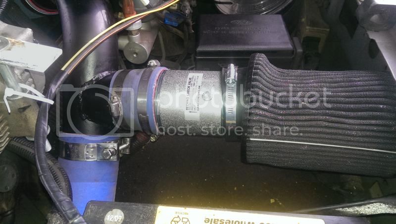

The 3" check valve is before the turbo.

Yes I have been driving it everyday for a few months now. I recently upgraded the blower and installed a check valve so the turbo can pull air from atmosphere when demand for air is higher than the blower can push. Runs great. I will be taking off on a hunting trip tomorrow that will put a couple of hundred miles down.

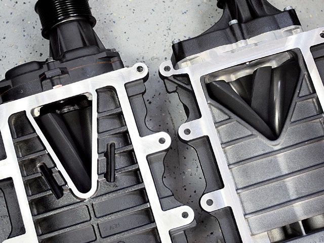

Blower is a VMP gen 2 TVS which is essentially an Eaton 2.3l TVS with an aftermarket case and snout modification to accept bolt on pulleys. Here is a quick example of the difference between the TVS style rotors and M122 style rotors. Blower stays cool to the touch even after a couple of hours hauling down the freeway. Which is as it should be as once the turbo spools it unloads the blower is in a bypass state.

Here is the difference between the discharge side the M122 on the left with the silencer slots and TVS on the right.
