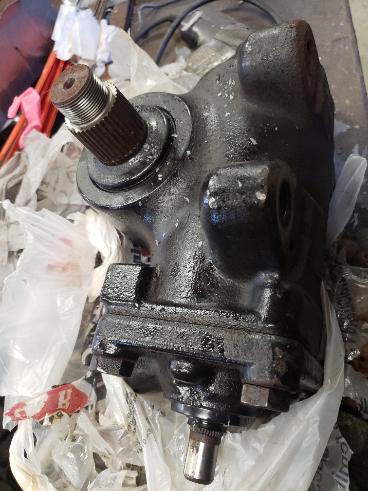

Anyone kmow where i can get a rebuild kit for the steering gear box on a 2008 F450? It works fine, just leaks a d needs seals. I have had no luck finding anything
