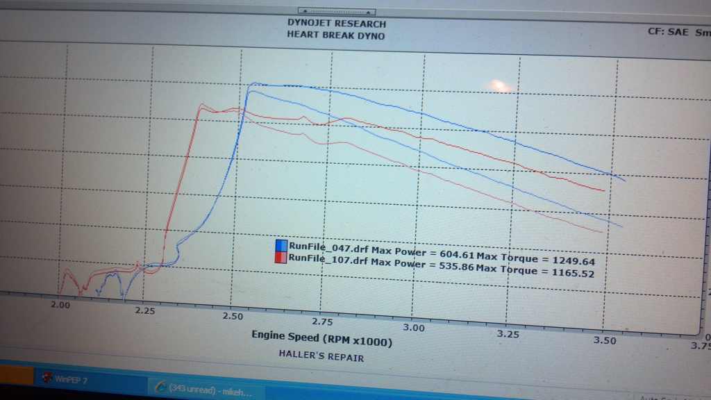

Well, the new motor has over 300 miles on it now, and it hit the rollers this morning. I've run some custom tunes, and done a ton of datalogging, but so far I have baseline numbers. For the purposes of this thread, I'll leave my custom tunes out of it, and all the results I provide here will be with IDP's 3.01 Xrace. As a reminder, it has twin pumps, 60 hp nozzles, and the baseline test has stock turbos. Here's some peak power numbers
552 rwhp loading it, and 511 rwhp not loading. The atmospheric turbo built 27 psi on the loaded run, and 24 psi on the non-loaded run. Back pressure is still within the safe range, so the gate hasn't been open yet. FWIW, I'm fairly certain my numbers are seemingly low partly due to how heavy the xrace fuels down low. I know it can do more, but for this test, all the data I'm putting up is from this tune to keep things consistent.
Up in a couple hours I'll have the same test results with the drop-in atmospheric batmowheel as the only change.

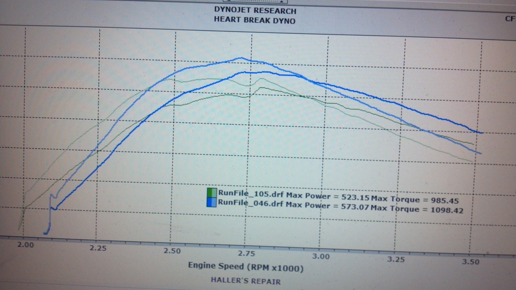

Well, I'm uploading pics of before and after dyno graphs to let them speak for themselves because I was quite surprised at the gains. I guess I'll begin by stating that this is a perfect storm for any turbo upgrade to shine...
twin pumps, 60 hp nozzles, 2.29 ms pw, intercooler, cam, high altitude, etc helped the drop in batmo put the hurt on the stock turbos. I'm sure after I put up the graphs it could cause a firestorm, but keep in mind we have a whole bunch of other turbo tests coming up, and the gains I got are very atypical.
We're mostly interested in how the upgrade turbos stack up against one another, so hopefully soon I'll get the next group of turbos tested. I hope this can turn into good insight as to how the mods perform, and we can all learn from this. I sure wish we had at least one 71 mm turbo to compare it against, but oh well. Graphs to come soon.

Here you are gentleman. First picture is a roll on run, second picture is loading the chargers with the brakes.
