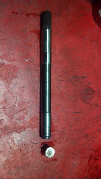

Well, I lost forward momentum on my way to work yesterday morning, so I brought the truck in the shop tonight to find out why.
I just pulled this from the truck a few minutes ago.:cursing: Until it broke, this is what was the strongest input shaft on the market.:fustrate: Needless to say, I'll be getting some custom tunes to tame the shifts. I'm gonna throw in my old billet input for now to make it through the necessary tests with my current programming, and allow it to be the weak link. I should have the next turbo on for testing in the next few days, so we can keep moving forward. With any luck, I'll have it running late tonight. At least it wasn't worse. :shrug:

The strongest shaft was not strong for the ford built tough to do the Job...
haha...
