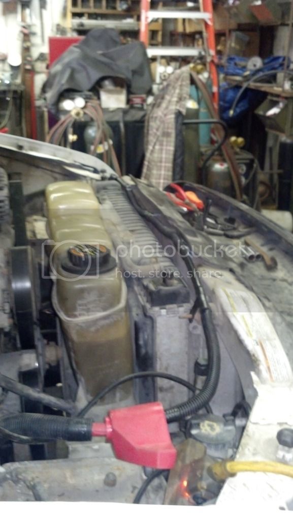

no the camera isnt tilted that how far the rear is up in the air lol
sorry for the messy shop...
