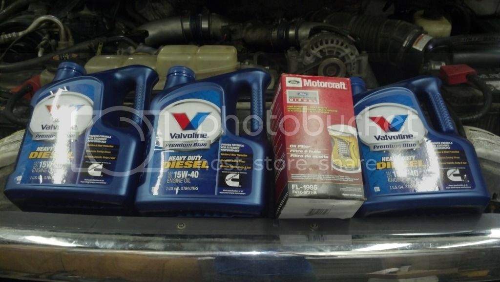

Oil change the other day

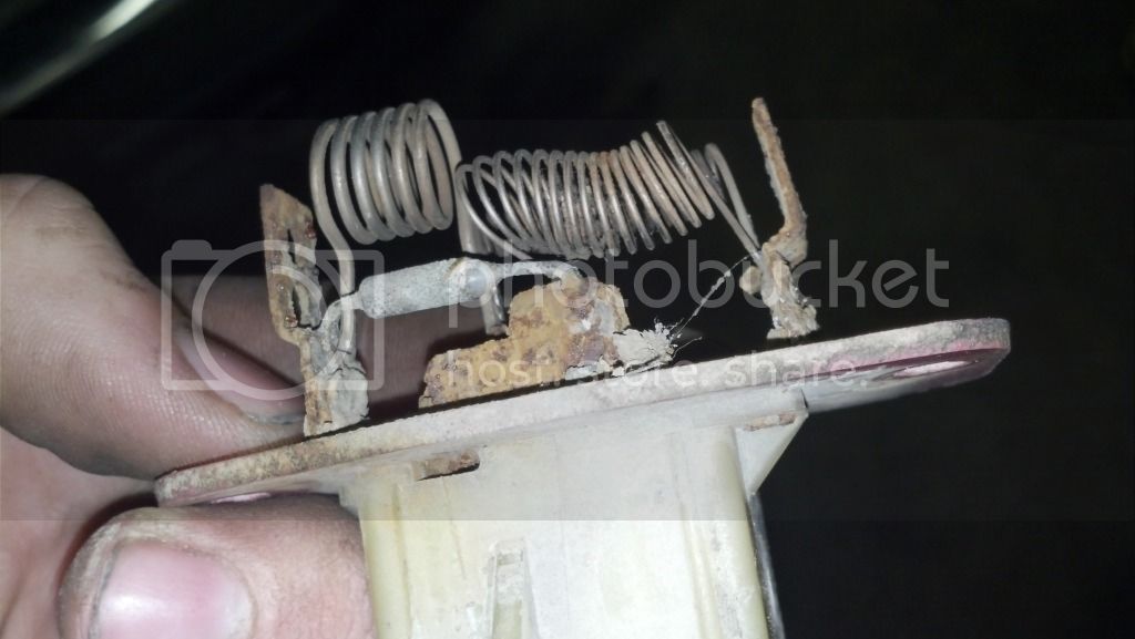

ReplCed the blower motor resistor my fan now works in all speeds !!
Before

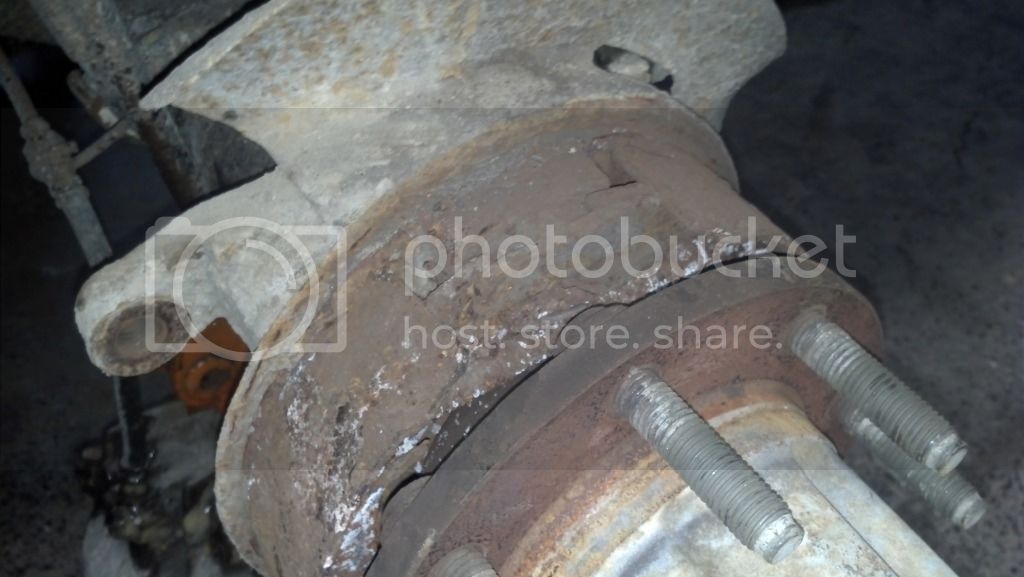

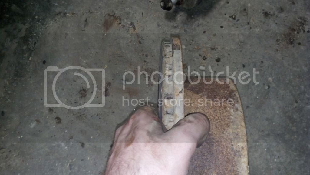

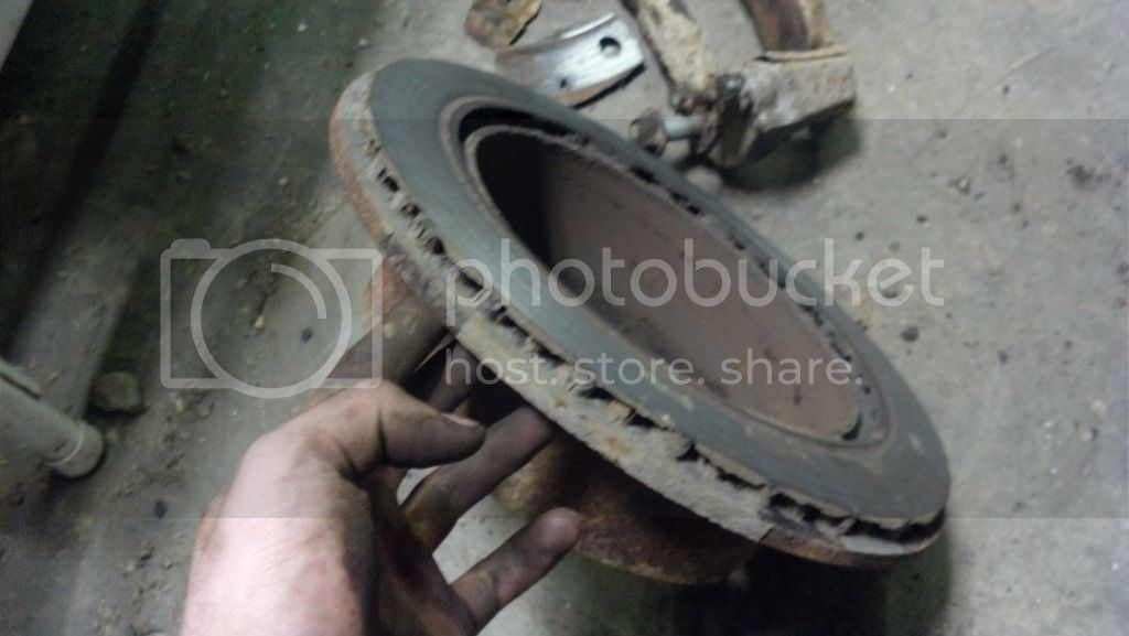

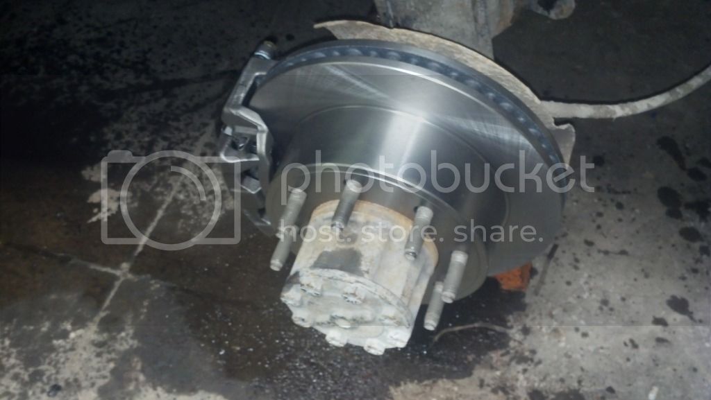

Found this beauty the other day while inspecting my brakes
My parking brakes. Thus may be why they don't work lol

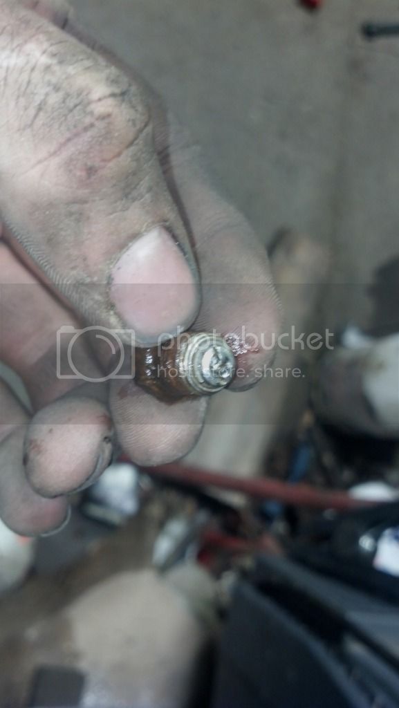

because the caliper was bad on the one side they decided to block it off with this method....
I had to put a new line on it with new fitting and here is the finished product

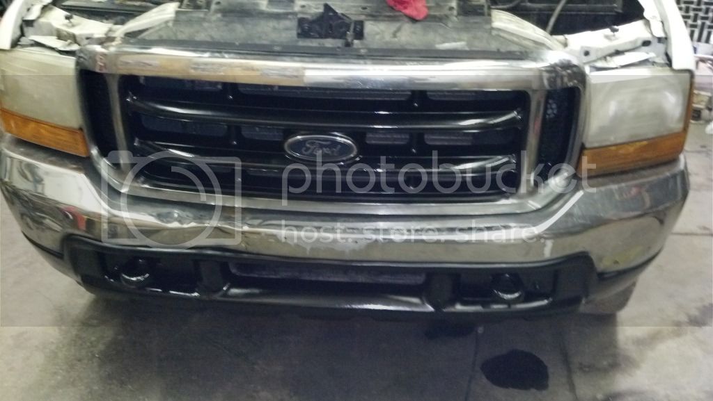

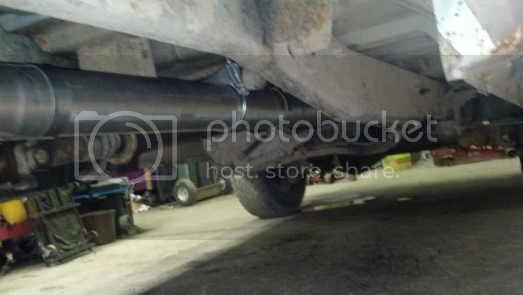

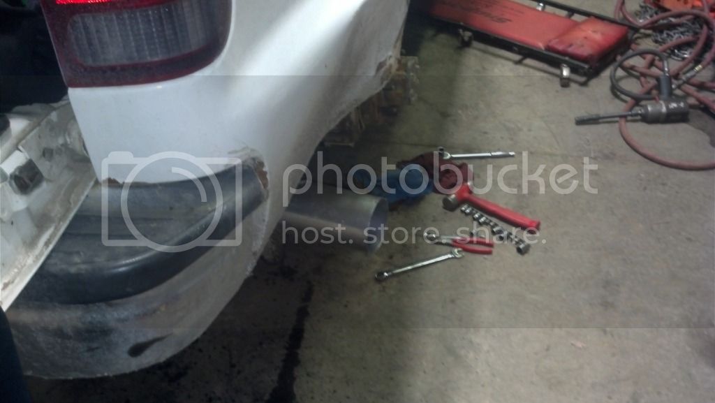

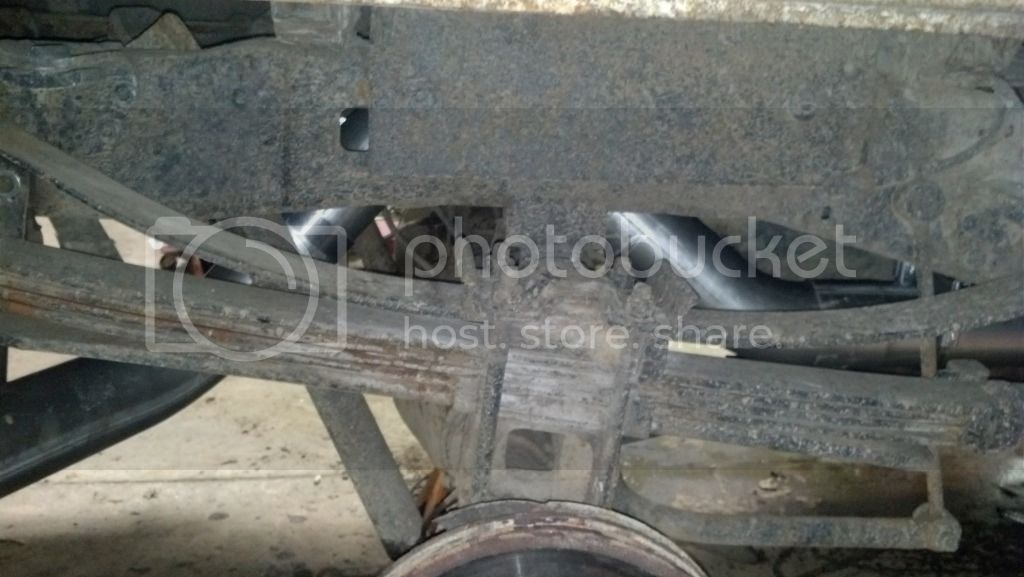

now some exhuast pics

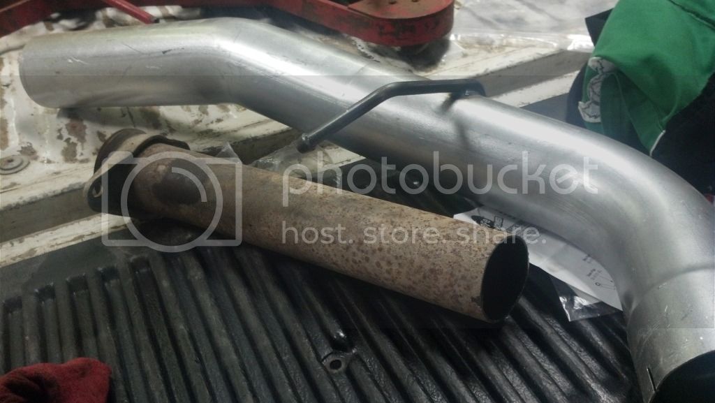

size comparison

What exhaust did you go with? How was the fitment?
sorry for long time sincei was on
It is a AFE aluminized.
It fit good. the DP was long so the trans X had to be removed to install on my zf6.

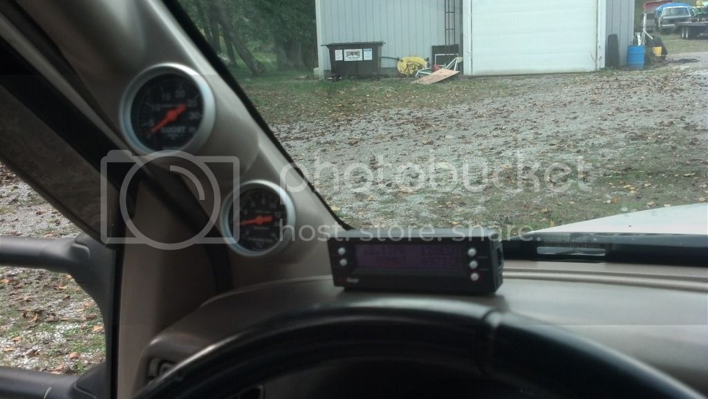

The truck has a bad MAP sensor it reads 1.4V at all times and supposed to fluctuate between 1.9-2.1 at idle and .3-.5 at WOT

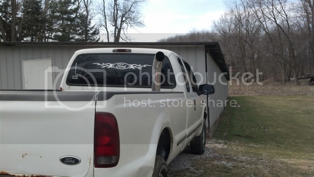

was playing with stack ideas today also
i like this one the best
this is just another one i found

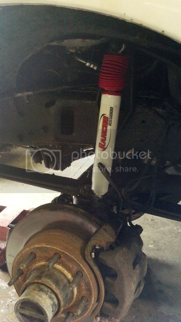

but with the truck. iv but all new steering parts under it. put 33's on it.
