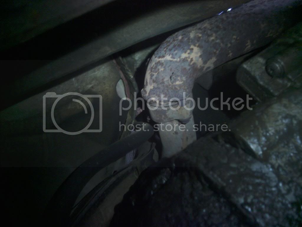

if you have ANY exhaust leaks before the turbo, it will heat like a banshee.....
get underneath it with a GOOD light, and check the exhaust manifolds (CAREFULLY, the block is black, and soot will be hard to see) and
the up-pipes....the donuts on the up-pipes are prone to leak, and WILL cause high egt's.
again, ANY soot showing means you have a leak, and will hurt the amount of drive available to the turbo..

So I checked it out tonight and am sure I got some leaks. I took a few pics and I am worried that I might have a bigger problem- I think it might be leaking out between the manifold and the block. If you look in the first 2 pics, just up and to the right of the temp probe, it looks like soot out of manifold. This a common problem?

cant really tell personally.
however it is likely.
my 96 had a few broken manifold bolts and I dident even know it.
I went ahead and got felpro manifold gaskets and new bolts.
also over time the heat cycles can warp the manifolds causing leaks.
from the factory these motors did not come with gaskets.
MossBack
Aug 22, 2011
934
UTAH
Driver side is not bad and if you pull the inner fender on passenger side it is easier. PB blaster will be your friend and a torch to cut heads off if it becomes stubborn. But hit it with some penetrating lube a few days before.
