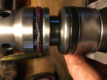

Well I’ve got 4 injectors out and 4 glow plugs. The #8 inj was replaced back 3 years ago when I had the reg return fuel system installed. Here’s a pic.

co04cobra
May 21, 2011
3,003
10
WV
No, that is oem colors. Others are just deteriorated more.
Colors go from bottom up. Orange, pink, blue, black, steel.
