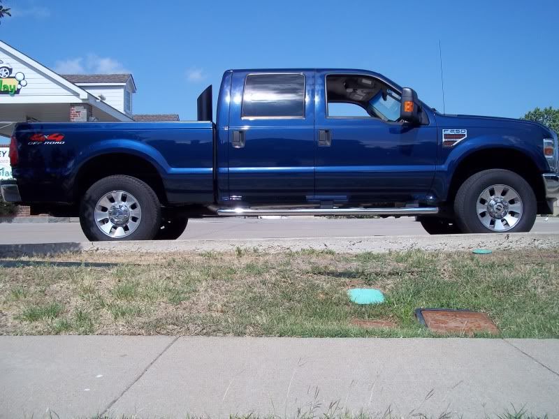

I vote stack, mine is alot louder than a stock 6.4 and ive driven it to ky and back with no headaches or anything, so what, my beds dirty but i dont mind it, the rear window doesnt get that bad, and anyways a tuned truck doesnt even smoke that much, do what you want, i think it would look great with a stack

Mike ur truck looks awesome. I always loved the way it looked. Especially with the black stack. Im still trying to get used to mine without stacks.

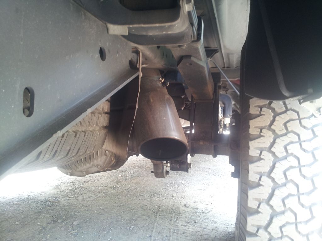

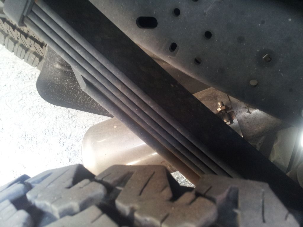

I have had every combo of exhaust exits and sizes I think you can have on a 6.4 other than a stack or muffler. I think the best sounding, loudest set up is what I have now. Loud When your on the throttle but reasonable quite with the Convertor locks and your towing down the highway. 4"dp, 5" the rest of the way, turned down after the rear axle, 5-6" tip facing the ground. You can get the same thing by cutting almost all the aftermarket exhaust after the axle and moving your tip back. If you don't like it. Grab a flat band clamp and put it back the way it was.
And btw. The only set up I never get any soot on any paint or wheels.

Got a pic of your set up dumping towards the ground?
