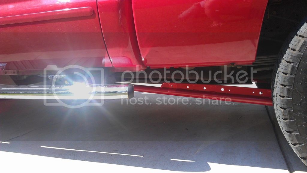

If you know a friend/good welder, he can help you out. I had my buddy who is a TOP NOTCH welder build me a set. $500 wasn't a bad price for me. Plus I helped a friend out. All heim joints and 2" schedule 80 pipe. These things are tough. Low pro mounted too.
