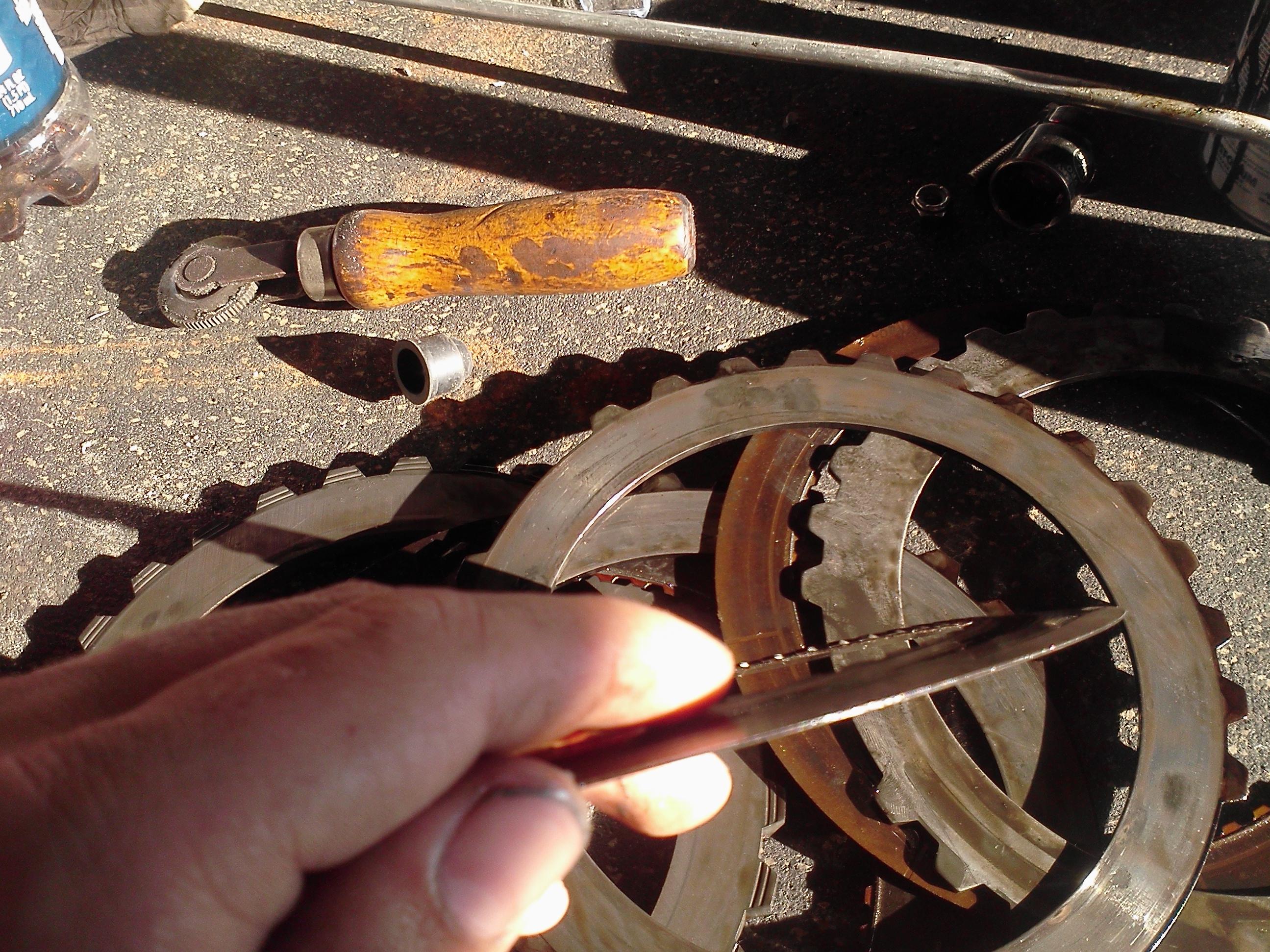

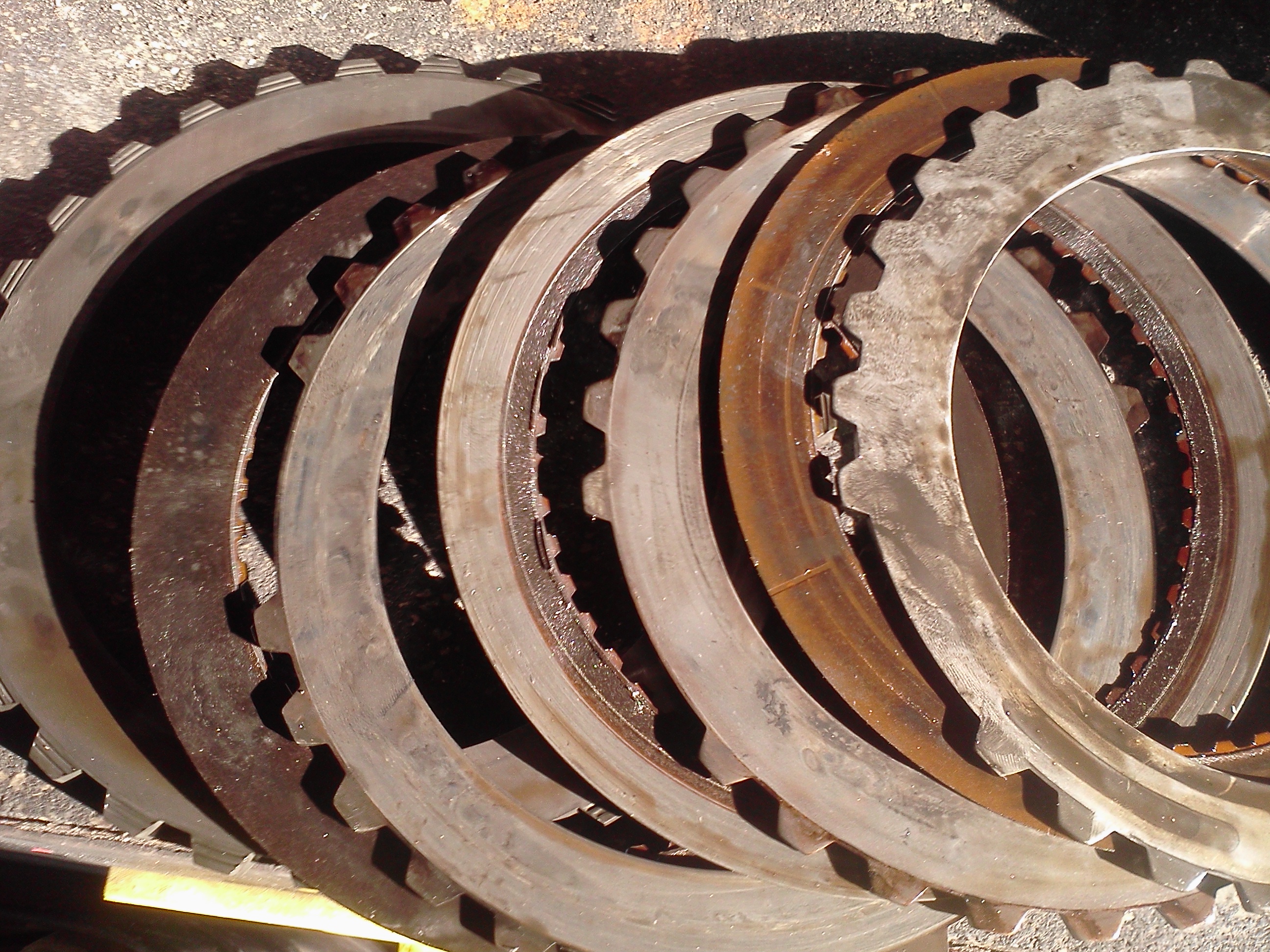

finally have some pics, the clutch pack i think is the intermidiate clutch pack and only the middle friction plate had no friction material left and was dished like a mother, other 2 were better but not great, the hole in the back idk if it is supposed to be there but you would think if it was it would have a cleaner cut, but let me know what yall think, thanks

I thought about that when i was looking at it today that it is cast, my bad, sorry ha, but why would only that one friction plate gone and not the rest?

So took apart the direct and forward clutch assembly and the first set of clutches looks brand new, the second ones i found 5 warped steels and frictions that were dished like a mofo and had even dug into the steel part of the plate under the friction material, im almost positive that this was probably why it wouldn't shift from first and wouldn't stay in second
