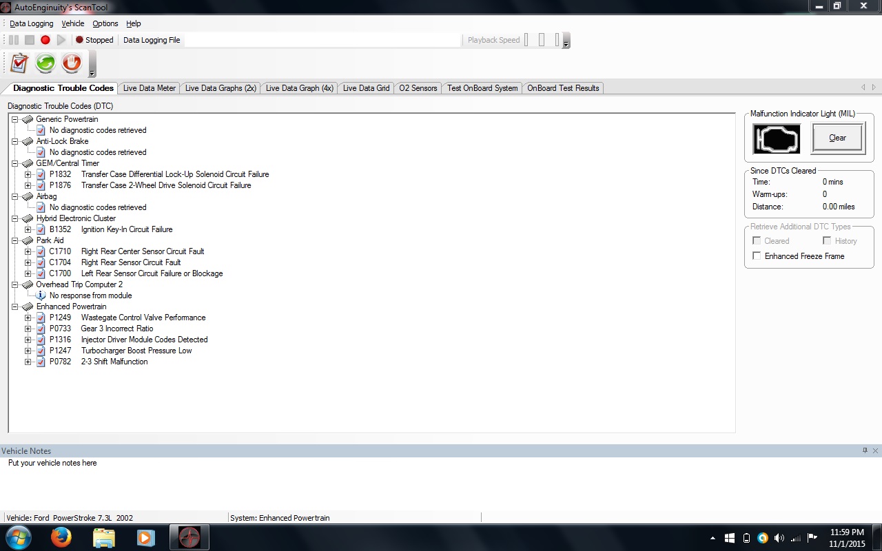

It popped codes the next day, it's in the screen shot above. 2-3 shift malfunction and 3rd gear incorrect ratio.

You need to ohm our your solenoids and also make sure your shift cable is adjusted correctly.
P0733 - 3-4 shift error because of shift solenoid A, shift solenoid B or internal transmission components.
P0782 - 2-3 shift error because of shift solenoid A, shift solenoid B or internal transmission components.
Both codes refer to your shift solenoids operating properly. Once you've ohm'd them I'd also drive it and make sure they're switching properly. Once verified, you can go into the valve body next.
Solenoids should ohm out to 20-30 ohms each.
A is pins 1 and 3.
B is pins 1 and 2.
