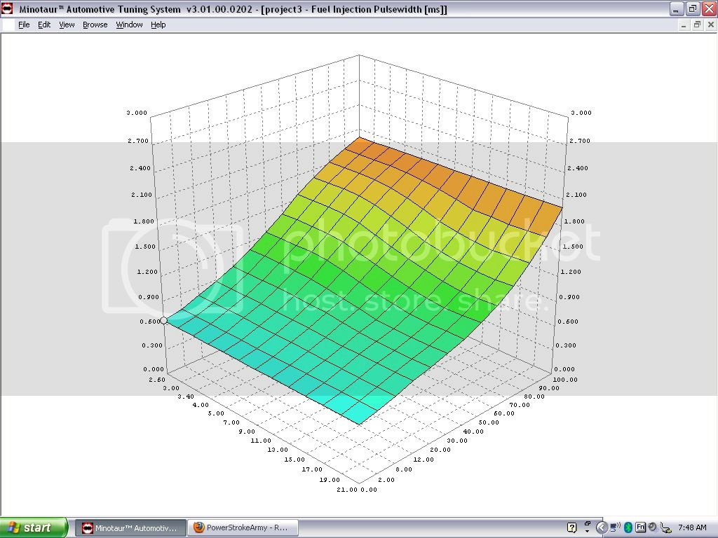

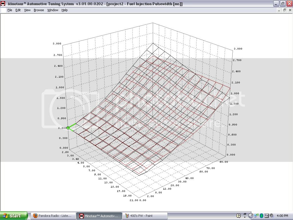

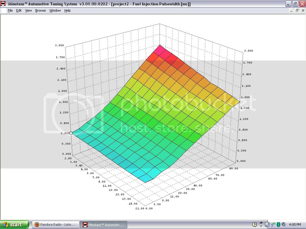

Here's an example of how I cleaned my truck up a bit.
This is the PW map I began with. I changed the scaling so you could see it better.
After a bit of driving and finding the main problem area's I changed it up a bit.
He is a comparison.
As you can see it really does not take much to get things under control. However, with larger nozzles things aren't nearly as drastic as they would be with a smaller nozzle.

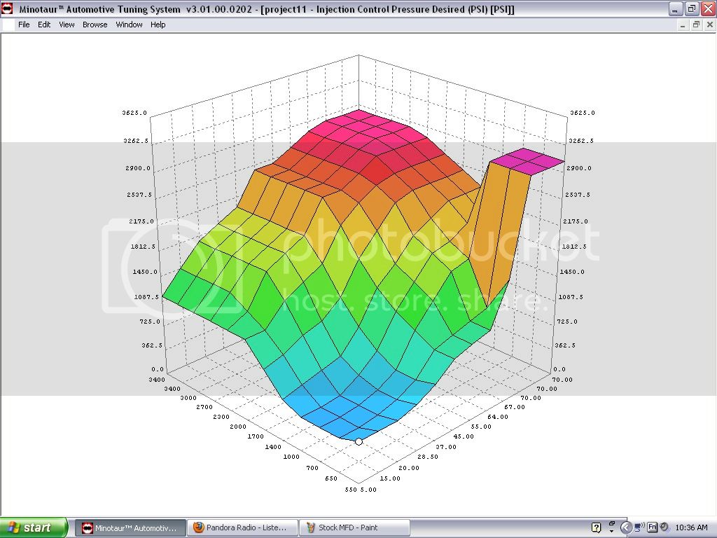

I feel like I am looking at something incorrectly on the most recent graphs. I feel like the icp scale should be flipped completely. Like the high numbers to the left and the low numbers to the right.
The way im reading it mfd increases and pw increases but icp drops, which im sure it isnt.
Hard to explain without being face to face. If someone can explain what it is that im seeing incorrectly it would be appreciated. If this dosent make any sence then il keep reading and eventually il get it.

MFD (bottom right) and RPM (bottom left) ICP (vertical)
Thanks
Do you feel that way because it has more pw at lower icp and you think it should be the other way around?
Aaron S
169
Correct.
How can the mfd scale be zero right next to the max icp pressure?

I'm not good at explaining but Ill try. looking at Dave's PW map you basically start at an idle in the place I marked and as you give it fuel you would travel in that direction. So even tho the mfd is 0 and ICP is max on the 3d map your not really over in that area very much if ever.

Thanks Shaw.
Makes much much more sense now.
