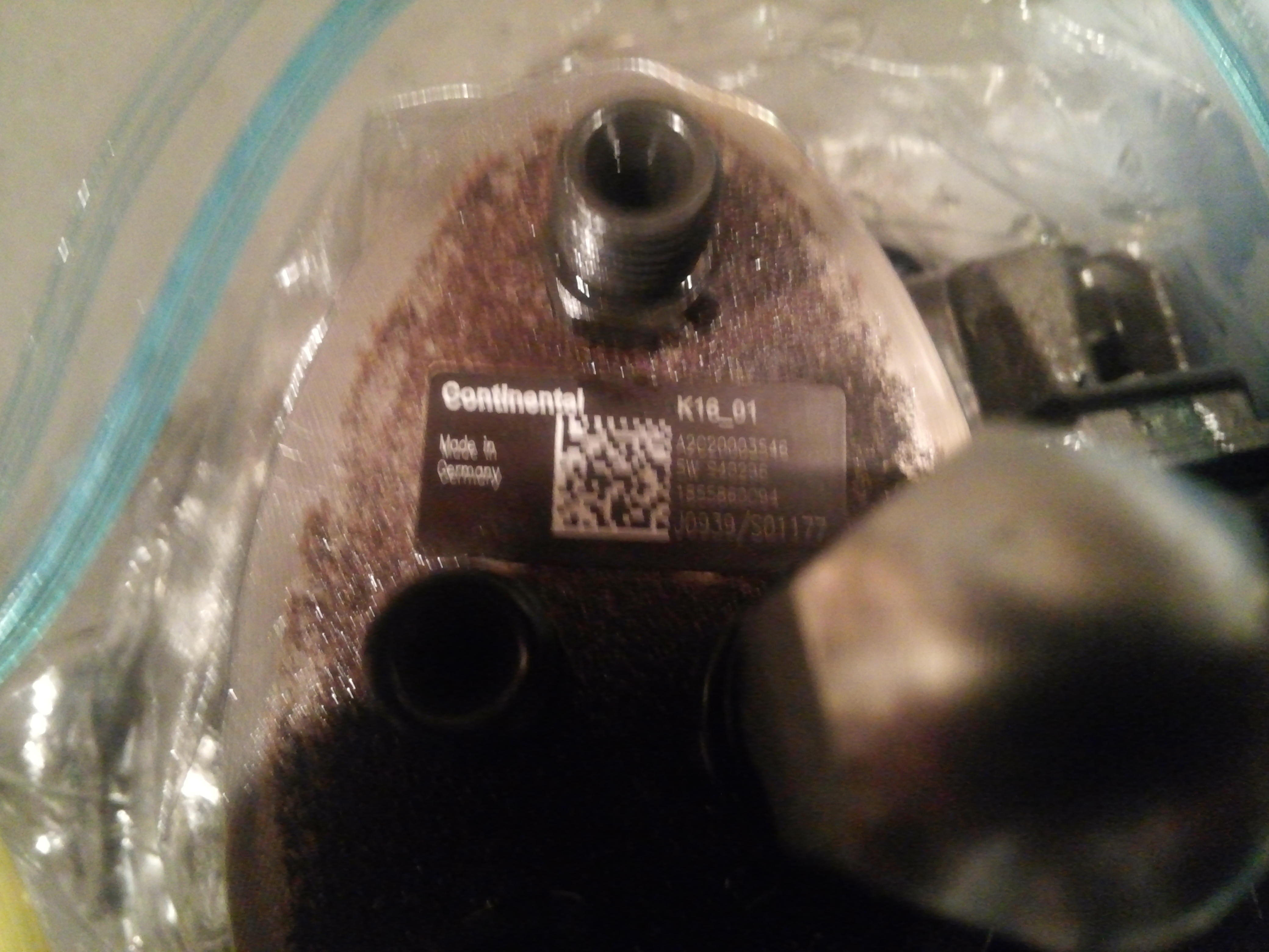

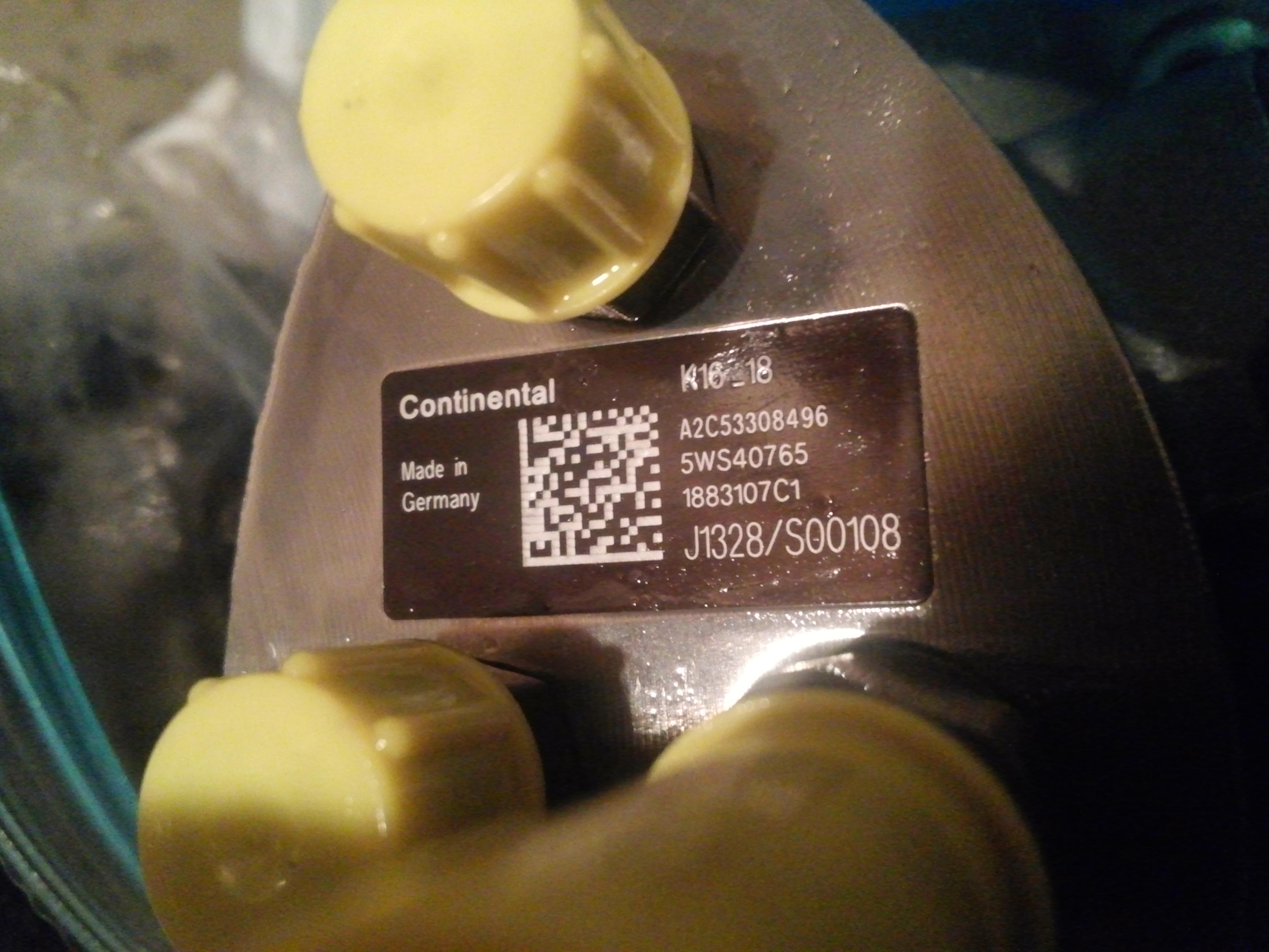

I wonder if this pump I recently received is rebuilt or new.
It did not have a snap ring in place and the color of the seal is a little different and the new one doesn't have ribs on it... so I would have to say something changed

They are all remans. We've been putting in the ones that say continental for well over a year now. Haven't had really any problems. Jerry's is due to -30 degree temps. Other than that no issues. But really we have good luck with them. Hopefully they get the temperature and seal situation figured out.
08BIGRIG
Nov 26, 2011
1,814
WI
If you have a pump with no snap ring on the shaft then you have a remaned pump. ALL new pumps are remaned. The only way to have one that's not is if you have one of the pumps that were being made until Seimens sold the rights to Conntiental.
