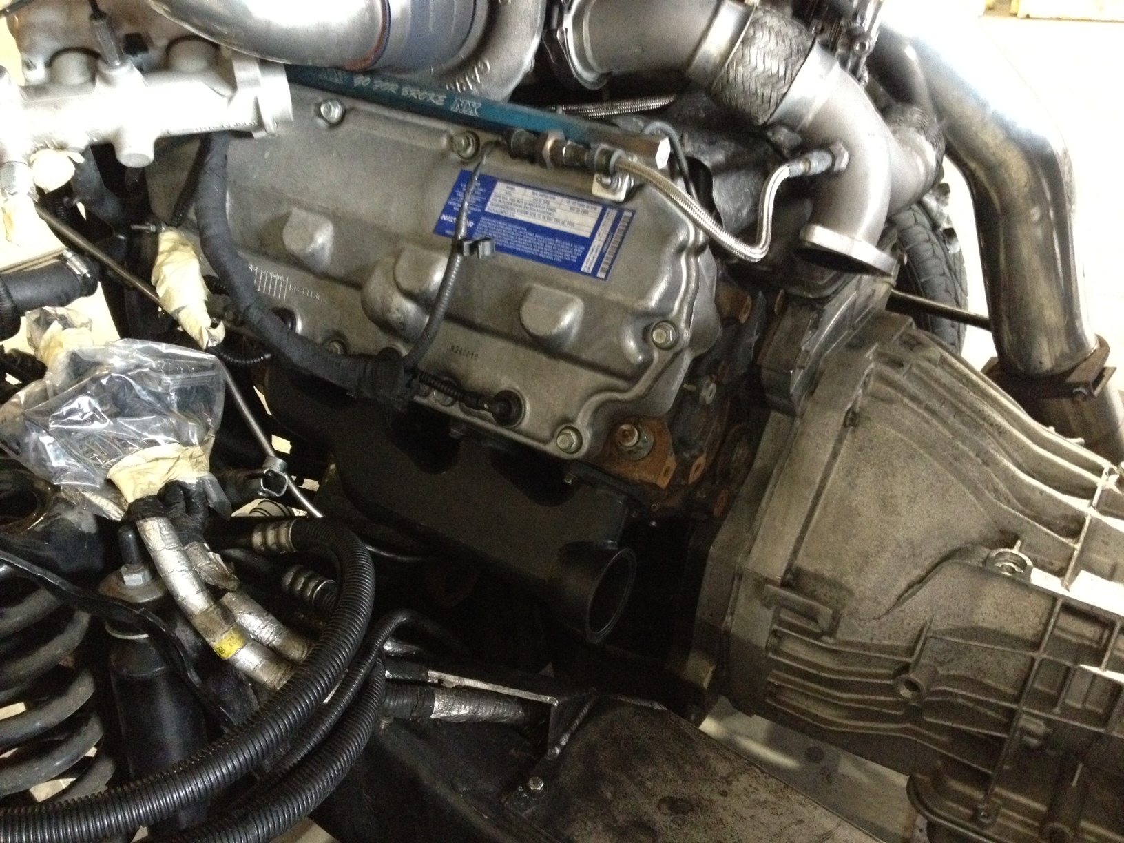

So I know a standard exhaust flex does not work
What have others tried and been successfull with? nothing with an inner brading as i have already had a bad experiece with that.
The wastegate Bellows held up should a guy just use that for flexes as well?
the steed manifold is 2.5 outlet and the Tial GT35R 2.25 inlet
where is the best place step to 2.25 obviously not in a flex pipe.
Because the old headers connection was so high we had the one side flex up pretty high we will be able to move them down and get a nicer 2 to 1 in there

http://www.spdexhaust.com/pdfs/AccPDFs/Bellows.pdf
slip joint bellows
i would reduce the pipe size after the bellow.
