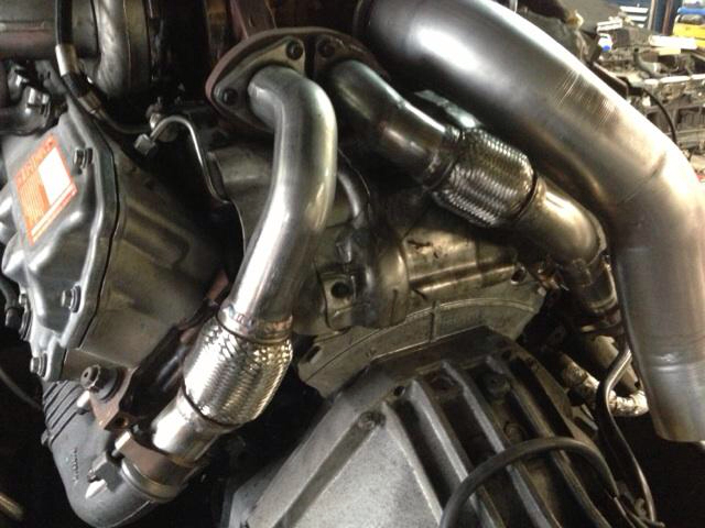

Unlike most companies, we offer a heavier wall up pipe that wont blow out like the stock thickness. We have our up pipes in stock with or without the egr provision. Street Diesel Performance also has a really nice aftermarket option to them as well.
Whether you go with ours or Sean's, you wont be disappointed in quality.

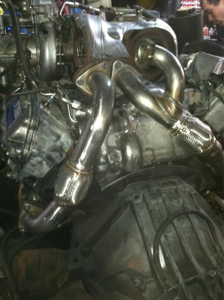

6.0 manifolds and custom up pipes are a good upgrade.

Cast elbow in the manifold doesn't blow out and flows better that a stock one. V bands on the manifold and elbow will work best to keep it as reliable as possible. That the plan for my truck this winter.

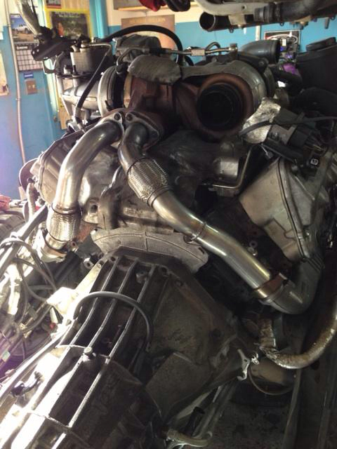

I'm Josh, I operate Darkhorse Diesel Performance. We fabricate custom up pipes for 6.0 manifolds as well as upgraded pipes for stock 6.4 manifolds.
