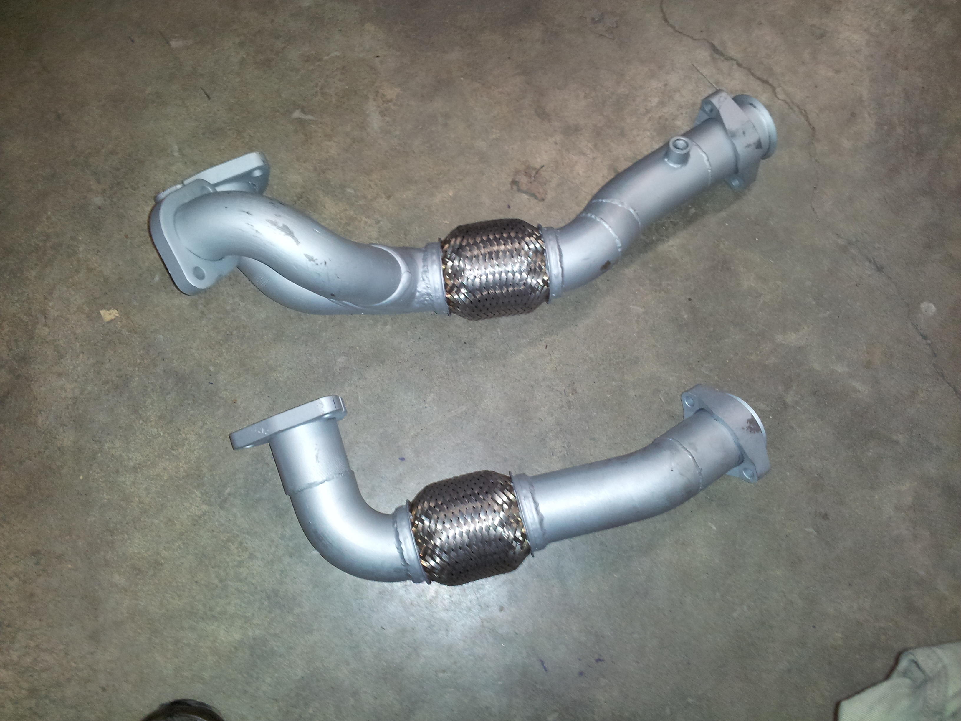

I wish I could convert over to 6.0 manifolds with some hd up pipes. damn emissions testing in MA makes me put my egr crap on every year so I need to keep the provision on the pass side up pipe in order to do so
we can build them with the egr provision in them for both the 6.0 and 6.4 manifolds.
Really? Suppose I could have asked, but I assumed they just wernt made because I had never seen a set. Going to shoot you a PM.

Josh can do it either way you want also. Got them ordered from him today. Wondering what for ceramic I should have mani's coated. Black or silver? Cant see the dang things to good anyway and I think black would hold up better.
