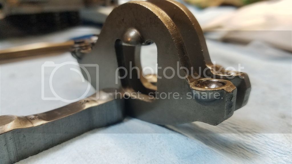

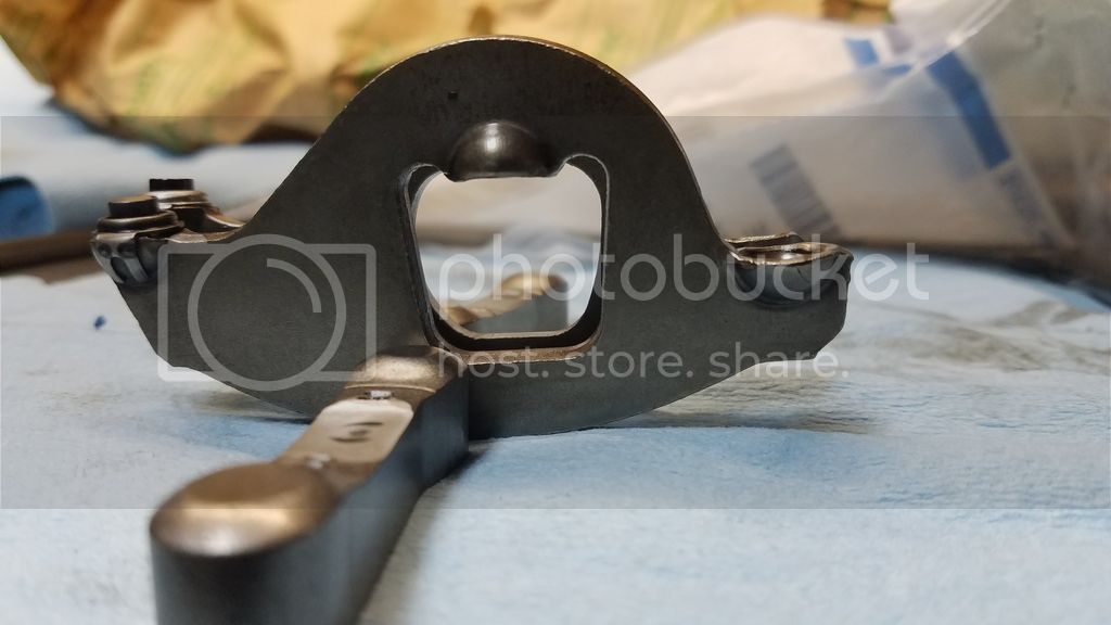

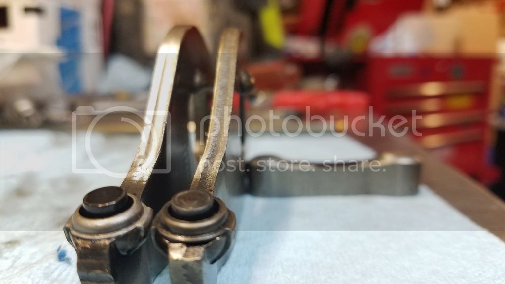

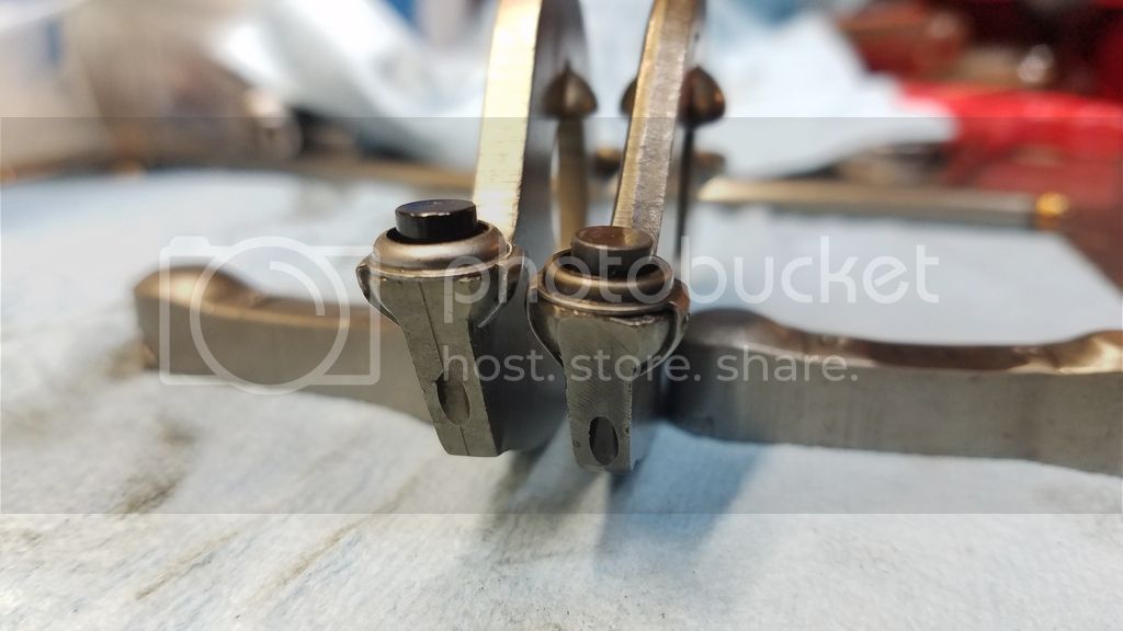

I still have my original rockers, so I can do some measuring, but I think I did this when I originally ran into an issue. It seems like the difference is in the arm and not the pedestal so it might be hard to determine exactly where the change is, but i'll take a look tonight. I do know that my original rockers have white clips holding the arms on, where the new ones have black clips if that makes any difference.

Pedestals are within .005 of each other, not enough to make much difference when push rods are approximately .050 different.
I can't see any difference between the two rockers other than the shape of the cutout for the pivot ball. It's possible that the tip is a tiny bit longer, but you are looking at a rocker that has 220k vs 10k on it so some wear could be there. The center pivot ball location looks like it may be a tad different, but I really can't tell for sure and it's nearly impossible to measure any differences. Very possible there is .010 difference on all 3 locations creating .040 difference overall but that is a guess at best.

Sorry, meant to add pics earlier.

And just to confirm the rockers are in fact what is different, I put in my original push rods with the new rockers. 2 blue paper towels between the rocker and the bridge and I start to lose a small amount of pressure. 3 paper towels and i'm losing 70%. So to verify, I switch to my factory rockers and I can put 16 paper towels in, and the rockers still wiggle and I'm not losing any pressure yet. Confirming, the rockers are in fact different, and the shorter push rods allow for the change.
