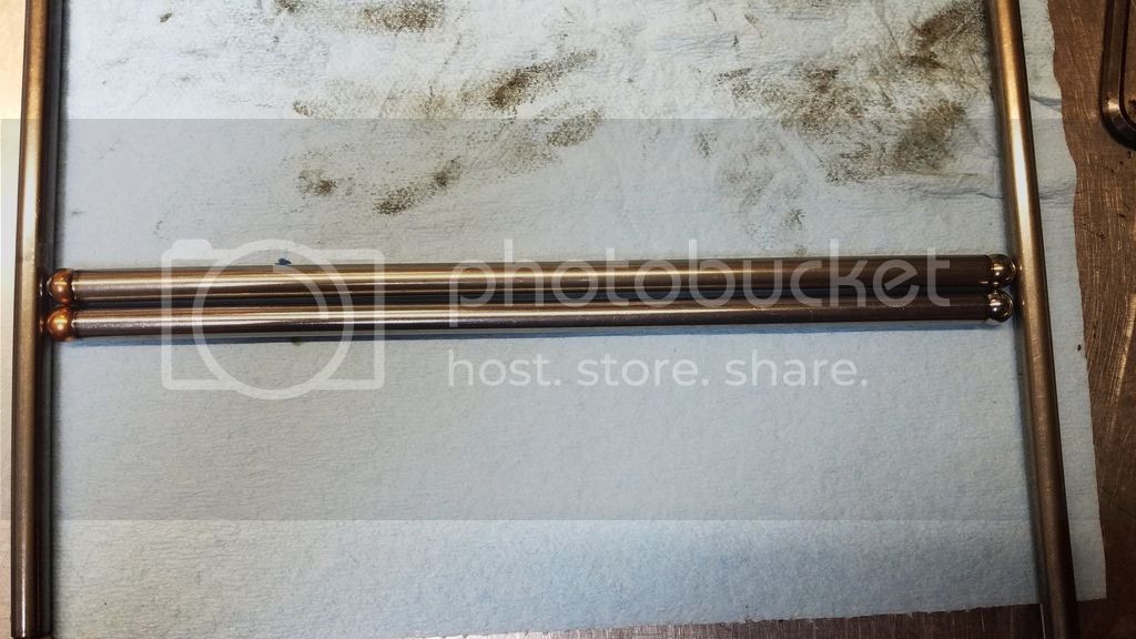

Well I'll be!!!! 96F350KID got it right! The new push rods are shorter than the originals! I talked with my reputable dealer that has a master certified (whatever the highest rank is) diesel tech and he said there is only 1 length push rod for a 6.4.... Looky here:
As they say, the proof is in the pudding.... THAT explains ALL of the issues I was having the first time around. WHY was this not ever brought up at the dealer and WHY does many Ford techs not know about this? THIS almost cost me an entire engine that just had $$$$ put into it...

Backwards there. The job1 trucks have the longer push rods which were replaced in later versions with the shorter 6.0 push rods. Since my stock job1 push rods were longer, this caused me clearance issues when I replaced all other parts. I think the change was in the rocker assembly causing a need for shorter push rods.
