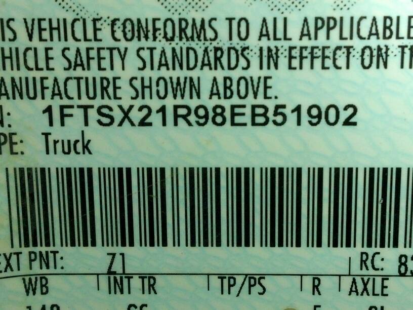

If someone could get the VIN off one we could look up part numbers to get an idea about if the parts can be had.

There's a VIN for you guys. An 08. Also you said the pics were bad, what do you want a pic of? I posted what is able to be seen, there is a blue coil, a bump stop inside the coil, and 2 limit straps per wheel. There's nothing else to take a picture of. Let me know.

Did a quick parts search by VIN and heres what i came up with for parts number for front spring
Using the VIN for the border patrol truck i got this
F81A-5310-AGD
#2, spring code D
(5600lb)
Using the VIN on my 08 F250 lariat with the camper package i got this
F81A-5310-AHD
#2, spring code C
(6000lb)
I dont know enough about the springs to know if thats the right spring or not. Just what the ford parts web site gave me. :dunno:
