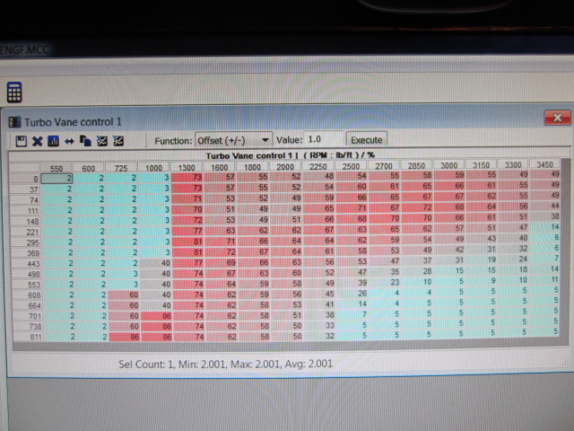

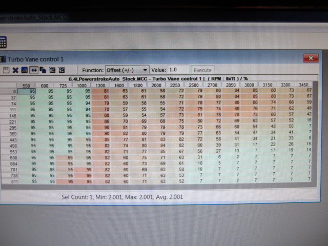

TravisH3 PM'd me for some info on the changes I made to the VGT tables. As I can't attach pictures to a PM, I'm posting them here along with a recap of discussion. The pictures are screen shots of the tables,
First set are Vane position control, First picture is my changes, then H&S, & factory settings for comparison.

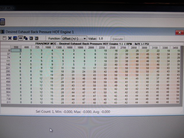

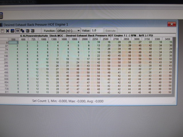

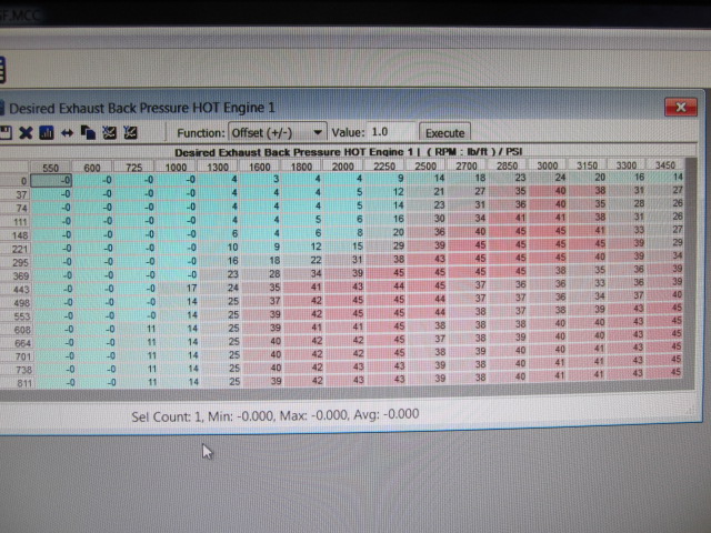

Second set are of desired back pressure, again my settings, then H&S & factory for comparison.
Keep in mind the changes must be made to all the tables, 3 tables for Vane position control, & 12 for desired back pressure.
Along with getting rid of the hairdryer sound at idle, I was also looking to see if there was any efficiency improvements by lowering the back pressure. the original 50% reduction I made across the tables made the truck laggy & smoke.
The settings I have installed now for Desired EBP are a 10% reduction across the tables & 0 below 1000 RPM with a taper in towards 600 rpm at the higher torque values.
The Vane position settings are 10% reduction across all the tables & set to 2% below 1000 rpm. The reason for 2% vs 0 was the minimum duty cycle ( travel ) for the vanes is set at 2% & there was some discussion about having the command exceed the minimum duty cycle and what effect that might have on the actuator & or vane linkage wear.
I didn't drive the truck much after making these changes as I took it off the road for the winter to do some upgrade work. I still haven't got it finished yet due to unforeseen delays in parts & my job getting in the way.
However, the driving I did get in I can say there was no perceived change to performance from the 10% reduction in the tables, & the hair dryer effect is gone at idle like in the video. As far as any gains in efficiency (mileage), I can't say as I didn't drive it enough.
If your just looking to eliminate the hair dryer sound at idle, just make the changes to the tables below 1000 rpm.

Here are the desired back pressure tables:
