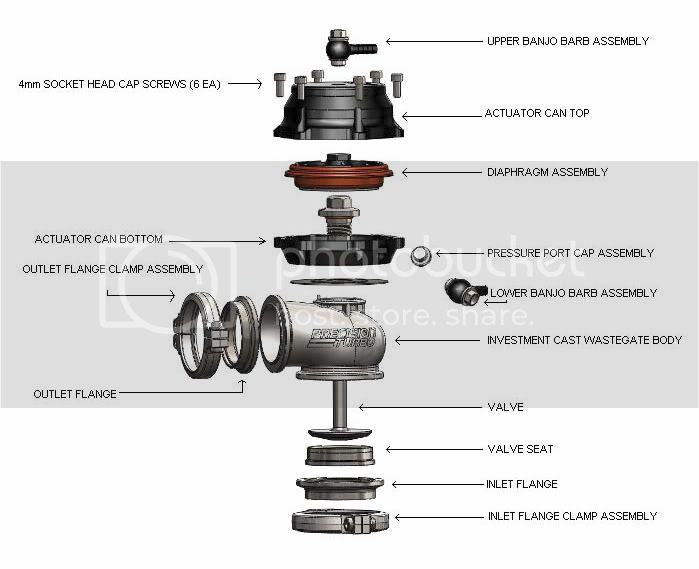

It seems to me that it just needs a heavier spring also since it works fine with lower tunes. It is an elite wastegate. I never pulled it apart to see what was in it for a spring. I was under the impression that the wastegate should work right with just the spring. Then boost was to fine tune it?
I am guessing by the image above. The part that maybe missing is the inlet or outlet flange? I can't see any other parts that it could be. Even if that is missing which i dont think it is. There's still no sign of a leak on the inlet or outlet.
