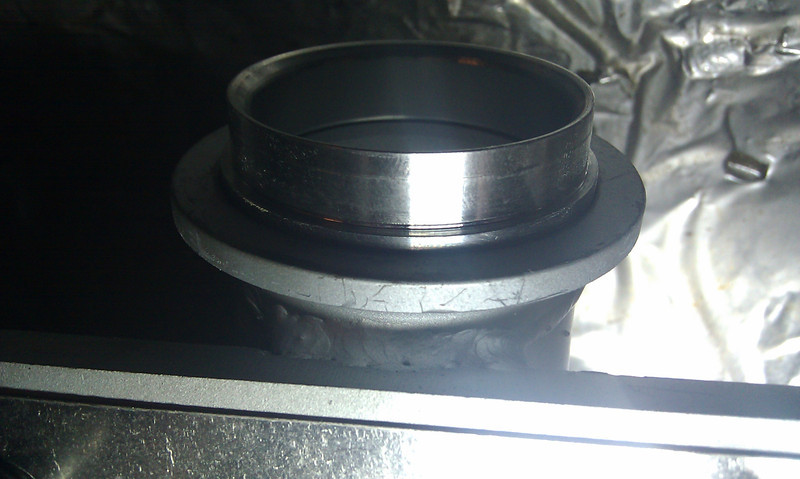

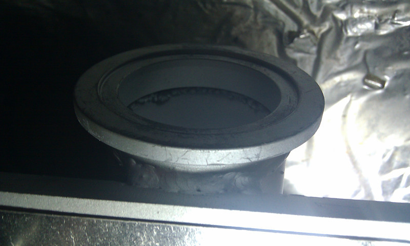

The piece I was wondering if it was missing is called the valve seat and it is the next piece above the inlet flange.

I don't think it would work at all without the seat. There is a 1/16gap around the valve without it.

There was not any tape to been seen on the gate itself. I remember looking over the gate itself and do not remember seeing what would be the valve seat. I actually remember wondering how the valve sealed anything the way it was. I was thinking it was a loose part that got lost, but maybe never made it to me. Maybe I will get some time tomorrow to pull it apart and figure things out.

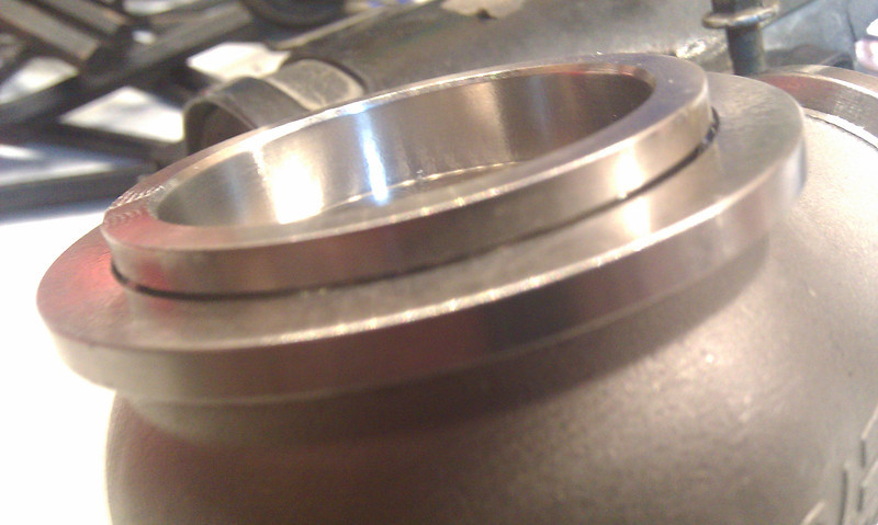

I had to use shop air to lift the gate open in order to get the inlet flange clamp installed because of the valve seat. The valve seat should be a fairly snug fit against your WG valve...
I'm assuming the WG location is a PITA on the 6.4 from the pics I've seen :shrug:
These pics may put the discussion into reference....I'm thinking you'd remembered this part if you'd installed it. It goes without saying...but without the valve seat being installed, you can see the potential for a drive pressure leak, and WG diaphragm heat damage, as exhaust gasses slip past the WG valve...
WG flange on a 7.3 dinosaur-
WG flange on a 7.3 dinosaur with the "valve seat" installed-
PTE 46 WG with "valve seat" installed-
Hope this helps. Don't know a thing about the 6.4 other than I wish I had one.
