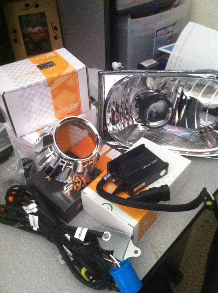

Got a set of morimoto mini h1 6.0 projectors with 35w ballasts and 35w 4300k bulbs with 2.0 Gatling gun shrouds showing up tomorrow. I also have a set of new clear lens housings separated and ready to retrofit. I should have some pretty freakin awesome front end lighting by Sunday evening.
BTW, if anyone wants a set of those ebay headlights that I linked earlier in this thread with the led's just let me know.

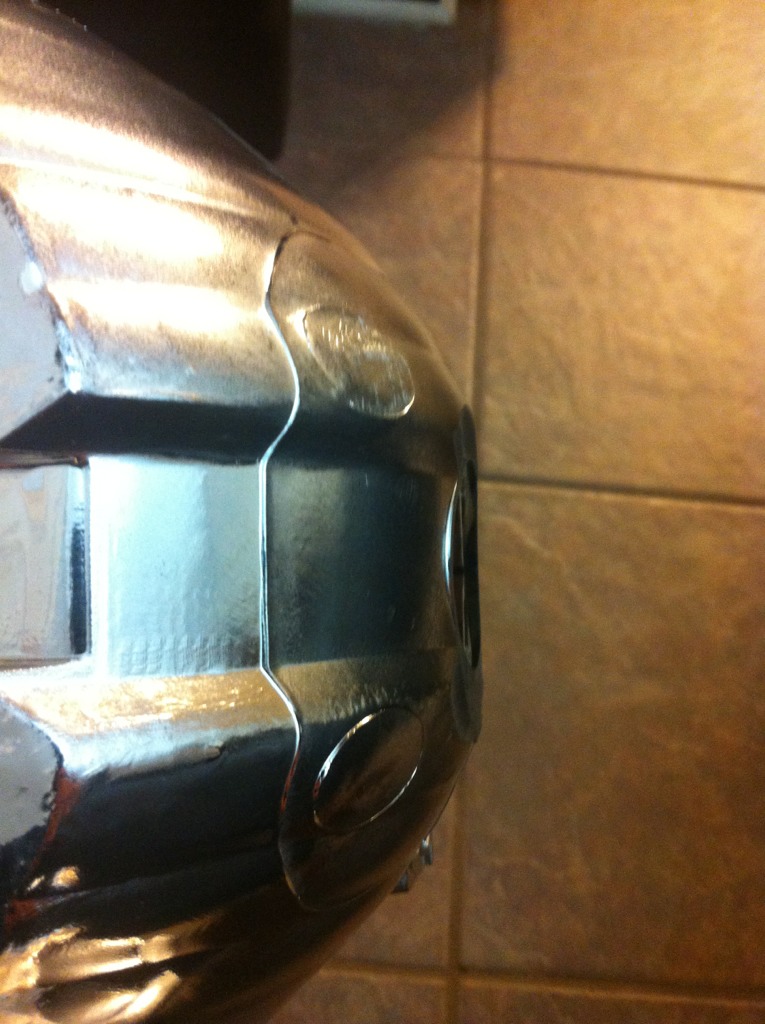

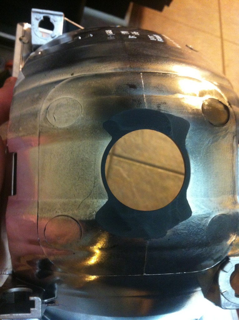

ImageUploadedByTapatalk1390705118.081627.jpgImageUploadedByTapatalk1390705160.445437.jpgImageUploadedByTapatalk1390705193.716746.jpg
I had a damaged lens holder out of the box as well as a fitment issue with the mounting rings for the shrouds so I won't be finishing this up for a week or so but I have things moving in the right direction.
The 9007 bulb socket in the housing is too thick for the threaded shaft on the projector to go through with enough exposure to thread the nut all the way down so some sanding was in order. If anyone does this just take care to note the plane of the back opening of the bulb socket before sanding so that the finished plane will match. Otherwise you may have to get creative in order to perfect the alignment.
I will epoxy a large fender washer to the back of the housing in order to reduce the size of the opening enough to get the projector mounted. When I get to that I'll post up a pic.
Since I have a few days before the replacement parts arrive I have decided to paint the reflectors and shrouds in a flat black to prevent any light scatter.
