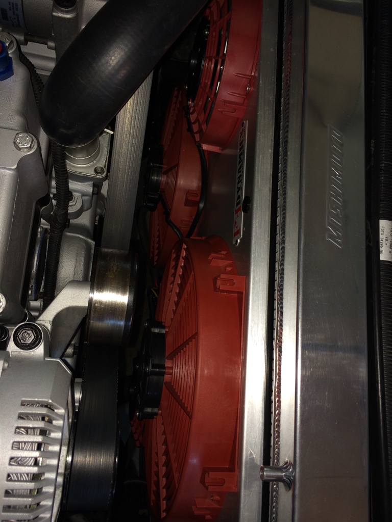

Finished wiring my quad e-fans rated at 7000 cfm. And got my new muffler in, waiting on the rest of it.
