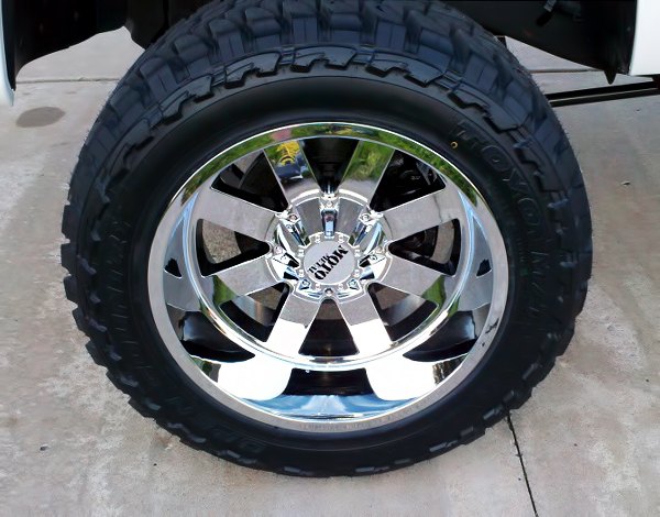

Do yall think some 20x12 -44mm bs 4.77 moto metal wheels with a 305/55r20 tire would fit my truck? if so if not and why? im okay if i have to do some minor trimming.... also if you have other tire size suggestions that would work better, please let me know

Yup they will fit. They do look small to me but its all the taller you can go... I'm at the very max for height and width and I'm running 20x10 on -24mm offset with 35x12.50 toyos

35s and 12 wide wheels won't work.... I'm running 10 wide and I barely clear....
