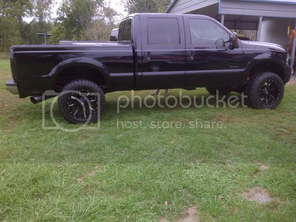

Ok gonna be buying wheels this week! I really wanna run a -24 so my tires stick out.... I'm running a leveling kit and want 35s but idk if I can pull it off for a bit until I can get a lift or not these are fuel hostages 20x10 -24 with 5"bs

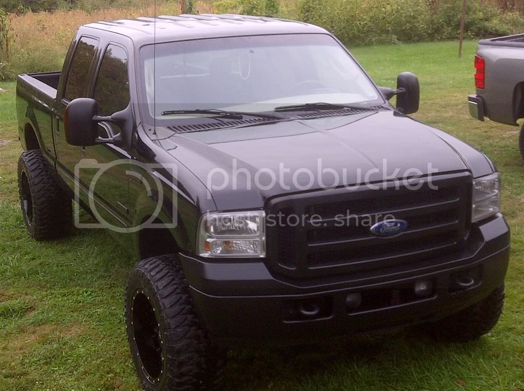

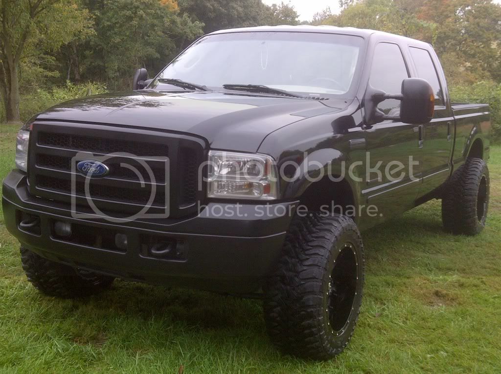

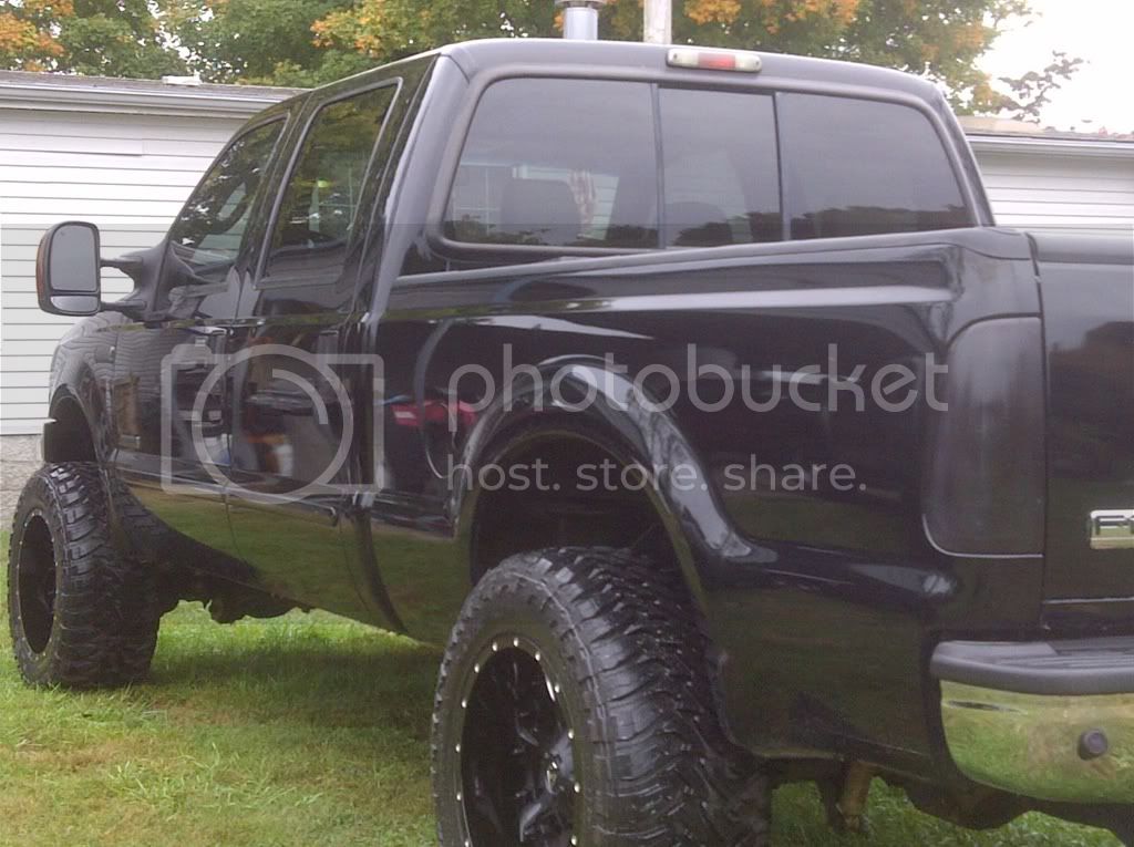

I am Running the 20x12 Fuel Nutz wheels with -44 os and 35x13.5 Tires man.. 3+1 level'in kit!! I would post some pics but dont I havent opened a new account somwhere too host them yet.. If you want I'll e-mail you some though. The Did rub a some so I trimmed my truck a little bit, but its Not noticable

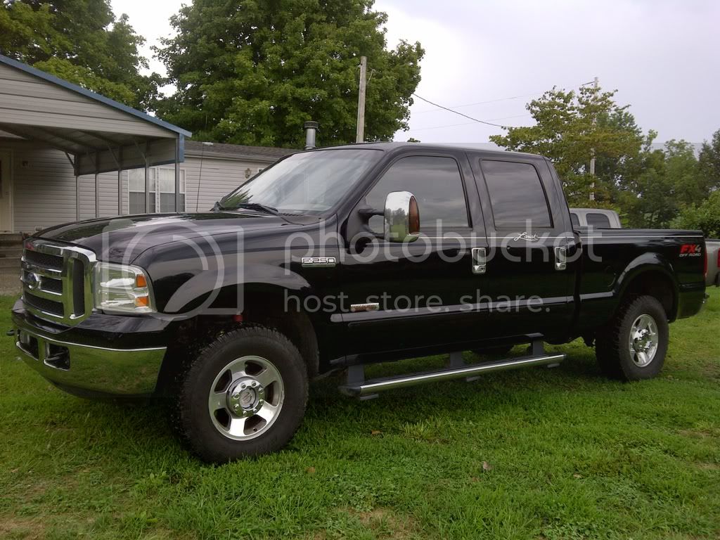

I know it's a 2008, but I am running 20x10's with -19mm offset and 35/12.50 MT's at stock height. The only time I get rubbing is on the drivers side if the truck is flexing a certain way. I would think you would be fine with a 2.5" leveling kit but then again I don't know how different the fender well size is on your truck compared to mine.

Well I have been told no it won't work, and then I have been told its dang close then there is the pics I posted up a bit ago and he is running way wider than a -24 and he is clearing other than the inner fender

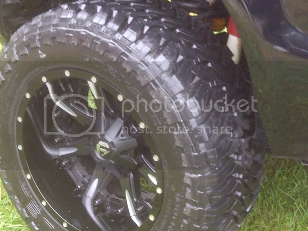

Its just the plastic inner fender. Once you get your wheels and tires on you see what you need to do. I ran 20x10 -24 fuel hostages on a leveling kit. It rubbed slight at full lock till I pulled the inner fender back and I just put a self tapping screw to hold it.

Seriously tho, I Cut the bottoms of the fenders behind the tire.. Not much you cant even tell it unless you bend over an look close I didnt mind as Iam building a custom truck but its personal preference..
Now, Alot of that is because I went with 12" wheels and part of it is because I went with 13.5 wide tires... and Unfortunately today I figured out that I Think I have a bent tracking bar, I dont know for Sure yet but unless a stock bar has a bend an curve in it at the bottom end, then Mine is bent! If it is bent I plan on ordering some stuff an building an adjustable bar! I think in theory if I go any taller it would need too be longer anyways?
Rightnow I think the axle is sitting offset too the center of the truck a bit too the drivers side where the bar is bent and its shortened in length.. The Drivers side was the worst By Far at rubbing too!!
