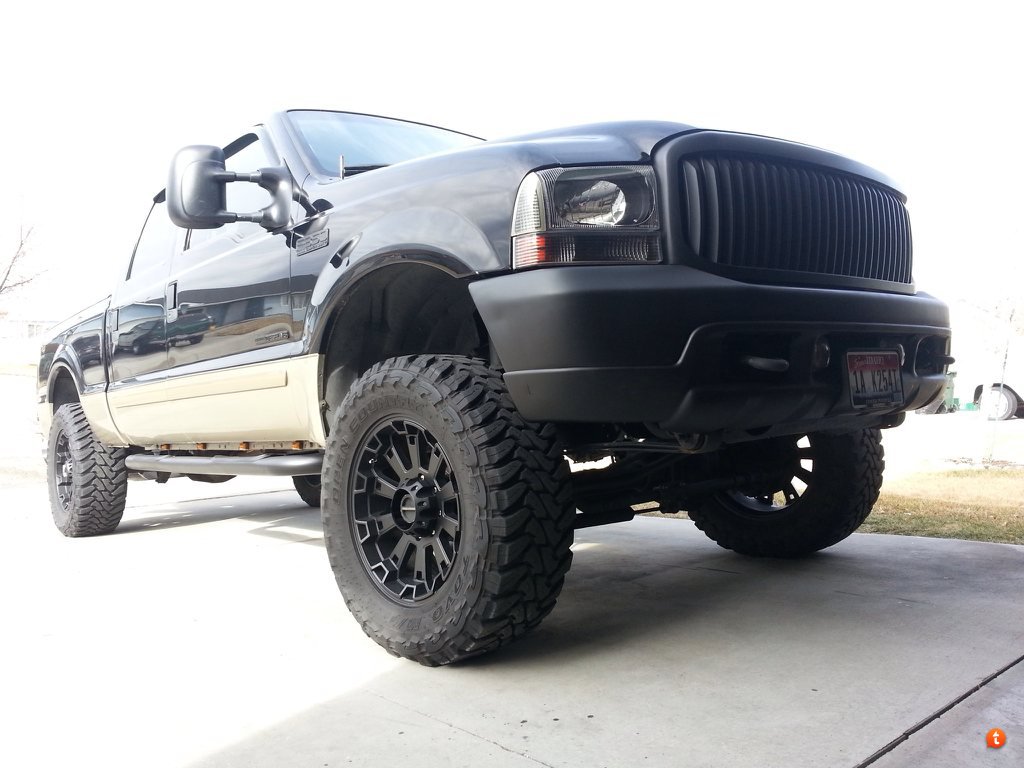

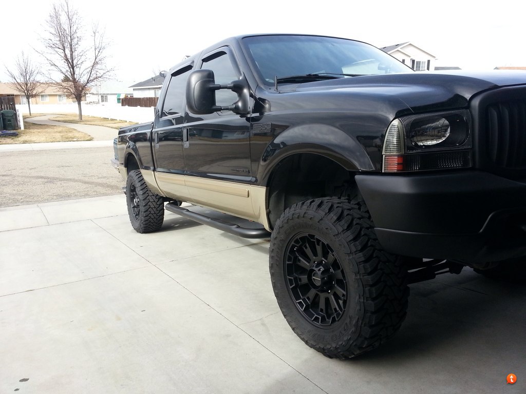

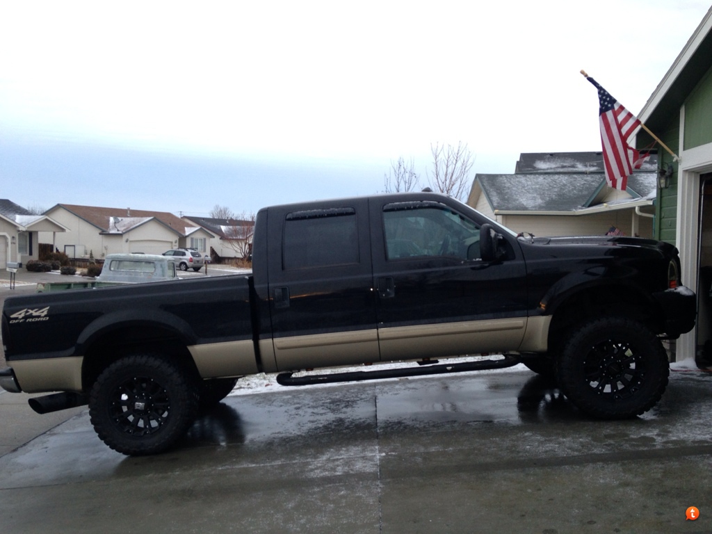

Quick question. 2002 f350 with a leveling kit. looking to upgrade to 20's. Can i fit a 35'' tire on it or is max a 33'' at that hight?
yzrmbsg
Nov 10, 2012
177
Mountain Home, Id
If it's 4x4, yes, 2x4, no. Depending on your wheel offset and width of tire, you may have some trimming to do. I have 0 offset with a 35x12.50x20 Toyo m/t and they rub the sidewall lugs on the leaf at full lock.
psdguy95
May 19, 2011
1,056
Effingham, IL
Yes its a 4x4. Rims will be XD spys -12 offset. Either 20x8.5 or 9. Do you have any pictures?
