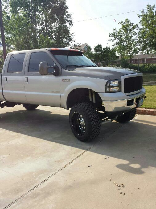

Just a heads up, in case anyone needed to know. 2001 F-250 4x4 Platinum 20x12 -44 offset fuel maverick 2 piece chrome with 35x12.50/10 Toyo Open Country M/T's. NO RUB PERIOD! 6.5" PRO COMP lift.
Sent from standing over the smoker drinking a beer.....
#1 Rule.......MAN THE FIRE!

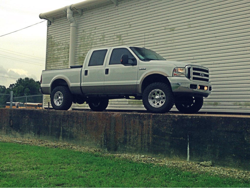

18x10 -12 offset 5inch back spacing on Toyo 35x12.50. No rub
:toast: Monica!
Lol, I'm running the same setup, rubs the liner pretty badly on the dr. side. I need to center my axle though.
And a little edit lol
