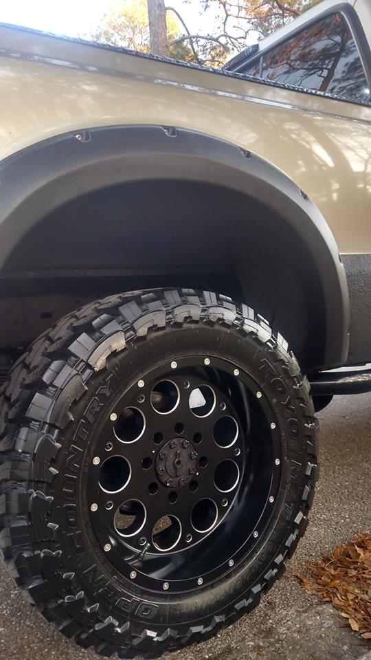

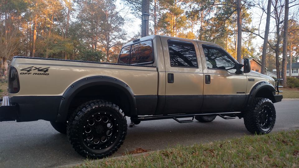

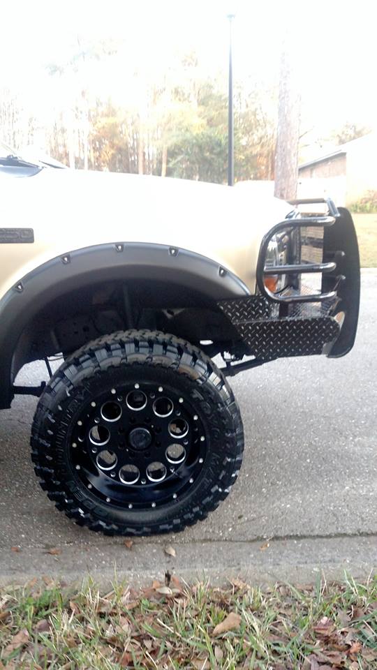

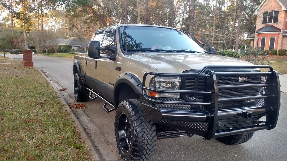

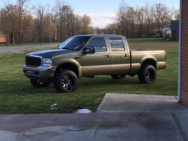

20x10 -24 offset with 35 toyo mts. Around 2.5 to 3.5 lift not really sure was on truck when I bought it. Still a little trimming needed to be done in the front.

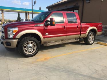

I have a question on my 2014 King ranch F250, it's stock with 295/65R20 and I was wanting a wider and more aggressive tire without doing a lift. I've been looking at 35/12.5R20 but every forum I've checked either dont say much about it and what little they say is no rubbing and some say slight rubbing on the control arm at full turn. I want to keep the stock King ranch rims as well. Anybody got any suggestions! Thanks
