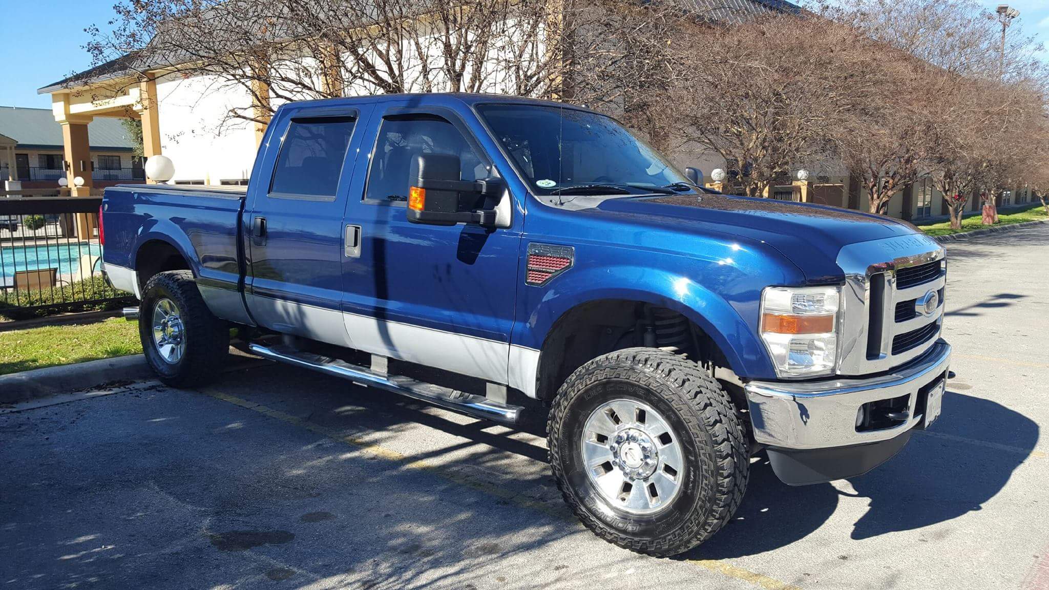

2008 F350. 2" leveling blocks upfront. Truck sits 1/4 inch higher upfront then the rear. 35x12.50x18 Coopers on factory 18" Alcoas. No rubbing.. Fuel mileage suffered horribly after this setup was put on. About to remove the front blocks and swap front Springs. Then remove the 3.75" blocks out back. Gonna bring it down , run some factory 20s and a 295/50r20 LT's or 305/50r20 LT's.

Can anyone help me ID these wheels? I think they're off an '11 but I'm not sure. They came on my '08 when I bought it.

those are factory 11+ wheels. came on lariats with heavy tow package.
