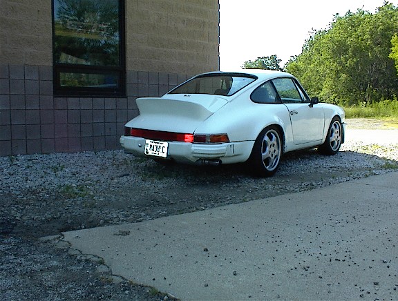

Here's a few old cell phone pics. Somewhere I have better ones from my camera. The first two are with 15" Fuchs wheels and the third is with Carrera Cup 17" wheels. With the short gear 901/911 gear box it's a total blast, barely get across an intersection in first. Hit's the redline in high gear (7000rpm). This car looks nothing like stock due to the front and rear bumpers and rear flares. hard to believe these came out in 64-65 and had 5spds, 4 wheel disc brakes and independent suspension, dry sump oiling, and mechanical injection was available.

chris the car looks nice. do you get out with it much anymore with all the kids?
Nope LOL. It's for sale actually. I have a buddy who's been trying to get the money together for 6 months to buy it. I want to sell it, pay off some debt, and then in 3-4 years pick up a newer 993 version which are the last of the air cooled 911's. My car's been sitting for like three years now in storage. I may get it out for the summer though. I don't a ton of conversion stuff to my truck, DRW conversion, 4WD conversion, long bed to flat bed, etc. Then putting my parts onto my parts truck for my neighbor to have a 1 ton 2wd to haul his camper around with. He does telecom installs and runs a few crews. Right now they take his CCLB DRW truck with W85 on the long hauls. His other crew truck is an extended cab F150 with a camper on it, sags really bad and get horrible mileage. The thinking is a 1 ton suspension will handle the camper a lot better and he'll be able to run W85. It's a win-win for both of us but a crap load of work for me. Would be nice to cruise in the 911 while my truck is down.

Awesome looking Porsche! One day I will own one. Untill then I'll be driving on w85 and high test. High test fuel goes in my second car which is an 07 Trailblazer SS that gets worse mileage than the F250. I do drive it like I stole it when I take it out though. It will be for sale soon to get rid of the fuel bill.
