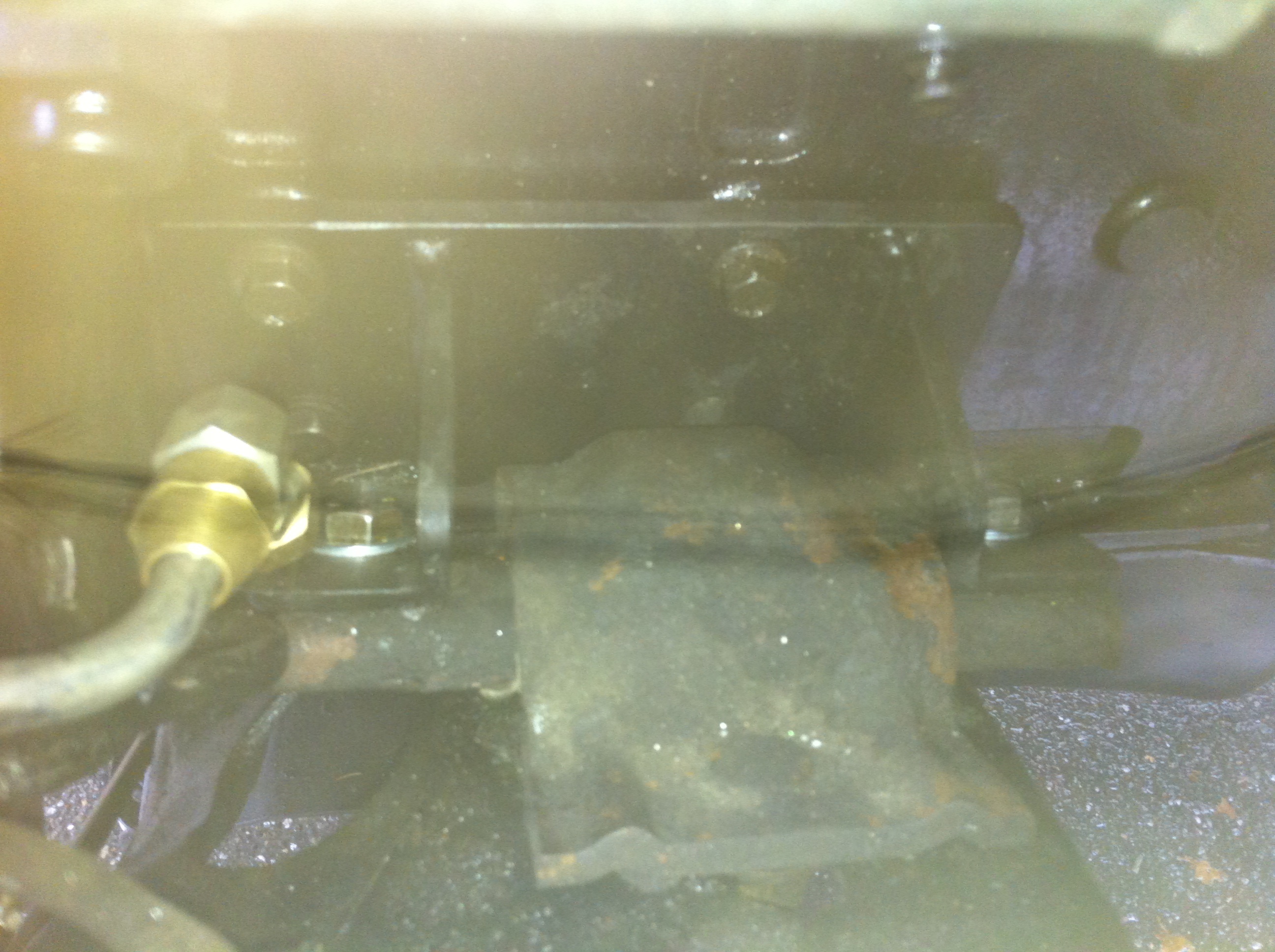

One more
Uncle_jesse
Jan 14, 2012
23
yea sorry the pics are kinda crappy i used 3/8x4" flatbar for the mount plate to the motor and and then used 3x2x1/4 angle iron for the tab parts of the mount .. when i built them all i did was bolt just the 3/8 flatbar plates to the motor first and then put the motor in the truck and got it sitting where i wanted and made templates from there they are real simple and could easily be made with a zip disc and 220 mig i might be taking them out to make another set in the near future and will try and get some better pics of them and measurements
