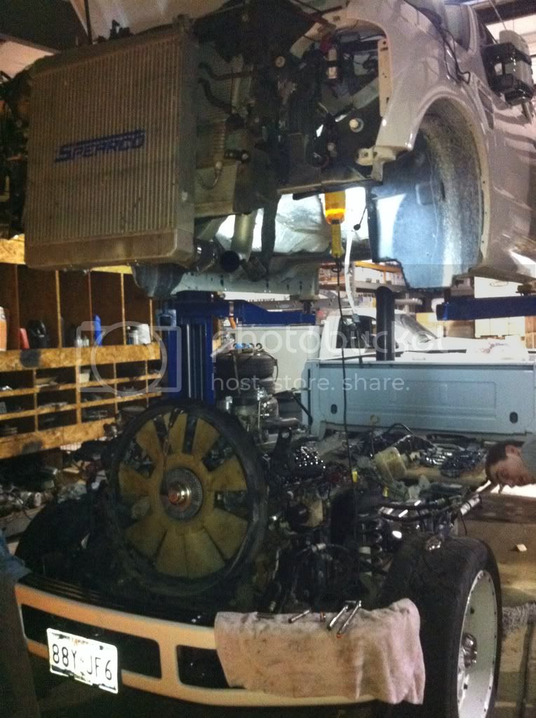

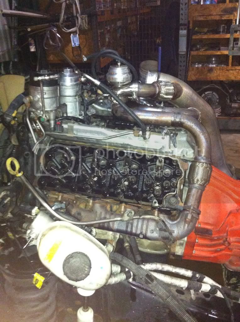

Cab was lifted last night. Valve covers, Injectors, Valvetrain minus springs, fuel bowl, fuel cooler and some other small stuff are out. I have some pics that ill post when i can and should be posting as progress goes.

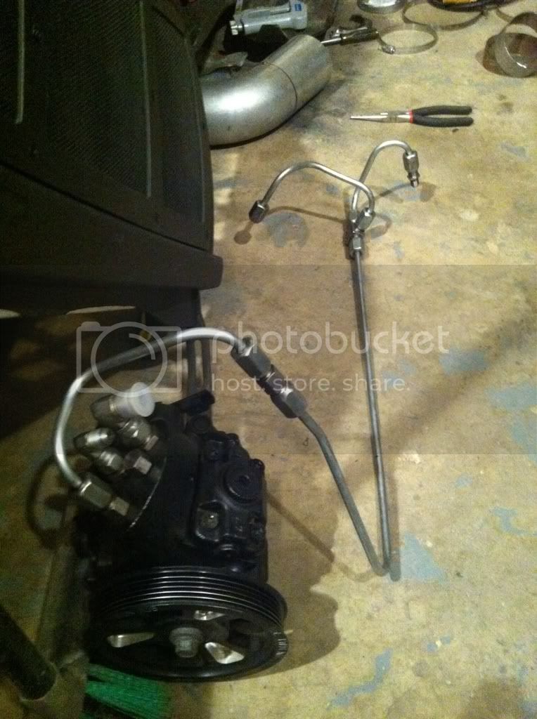

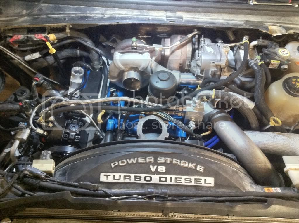

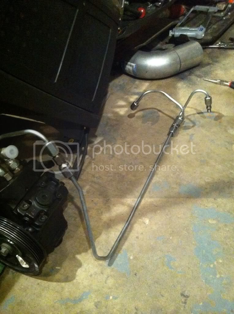

You were asking how the dual fueler lines go so here you go.
Here's how the lp systems ties in.
Sorry the last pics not perfect.
Well that's all I got for ya for pics. Make sure the "T" junction doesn't touch the hpfp electrical connector or you'll have issue later on due to rubbing and grounding out. Have fun.

Whitemonster, are those hp lines custom made or do they come with the kit? Do you know what the pressure rating is on them?
