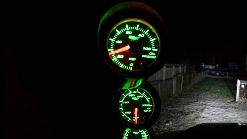

Here is after the trucks been running for 40 minutes at and 50-65mph for about 20 minutes. Which I just got done doing.

Where is your sensor? Sorry buddy but that is not right, your truck would run like ass with oil temps less then 100*.

My probe is on the driver side I'm the block right above the oil pan. They are glow shift gauges, and I don't have a picture currently
