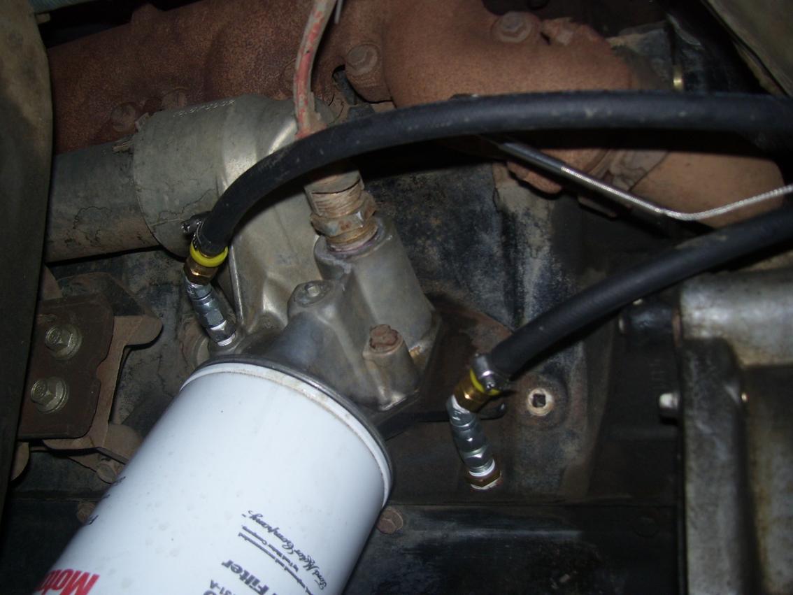

backwoodsboy
Mar 9, 2012
1,507
Merica
Pretty sure that hole is just splashed with oil...
If you're talking about the hole with the bottom right fitting in this picture, then yes this hole does see oil flow when the engine is running, but only when it is running. It is the oil return galley, and is typically where OBS guys mount their oil pressure safety switch when installing e-fuel.
