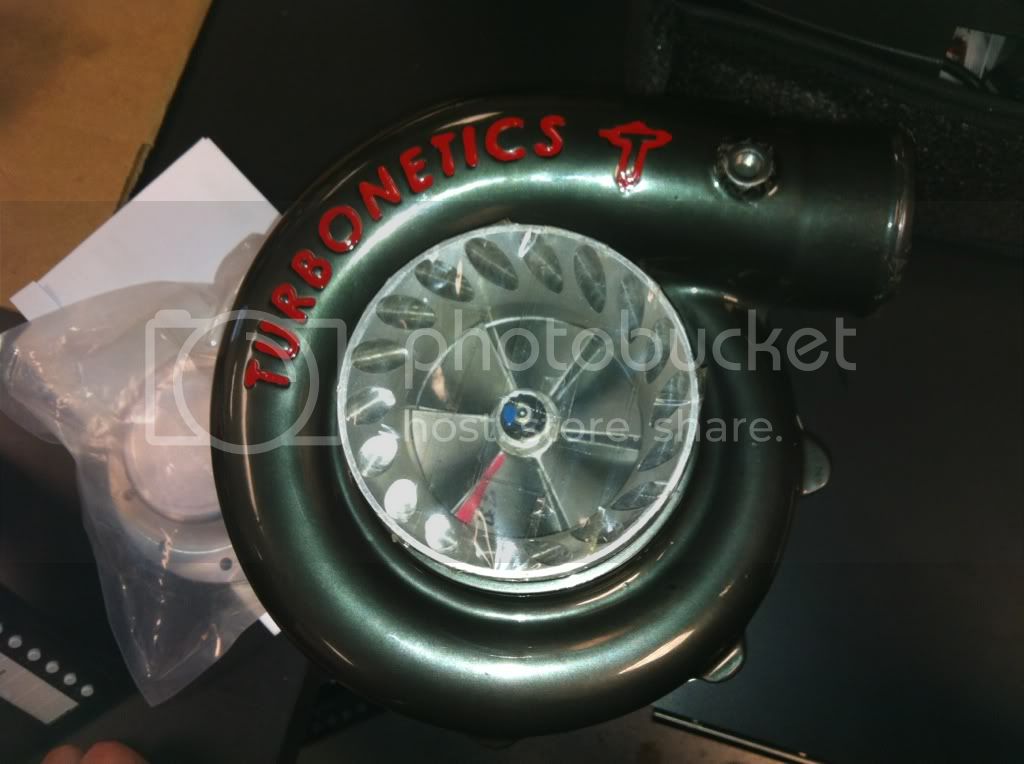

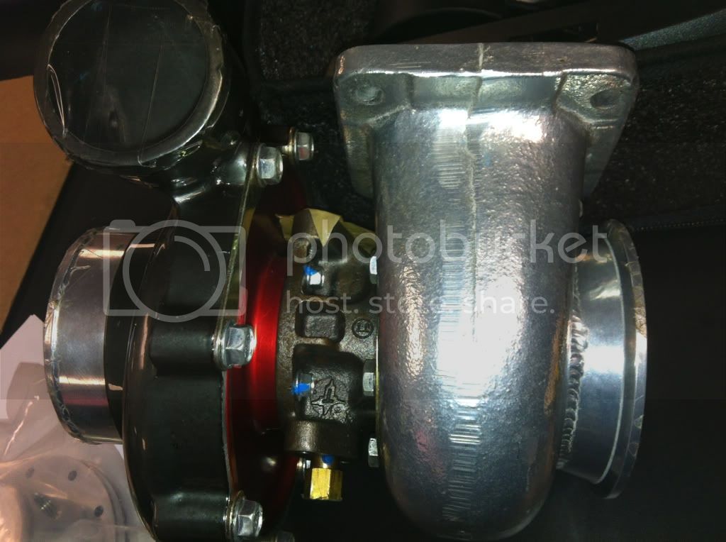

This thread needs a update. The MPD S366 kit works great and fit very well, and runs like a champ I literally have no complaints about it what so ever. But I am moving up to a 76mm dual ball bearing unit, I'll post pictures of the install once I have the rest of the needed parts. Till then here is the turbo.
Turbo specs are listed below.
Comp 76mm IN
Turbine 68mm F-1 Trim
Turbine Housing is a .96 A/R
Compressor Housing A/R is .70

You're going to run this as a single? Hopefully it spools well for you if you plan on driving the truck all the time.
SEABEE08FX4
7,463
4
Montgomery TX
Well the exhaust housing is the same size but it's an open instead of divided, the dual ball bearing center section spins effortlessly so I don't think it will be an issue but we will see. I'm still going to add more fuel to it later too so that will help for sure.
We'll see guess, either way I practily stole this turbo so it's not like I'll be out any thing.
