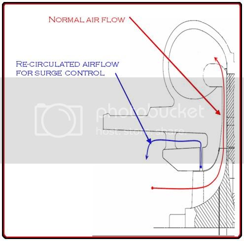

Just an illustration from Garrett
A Ported Shroud compressor (see Fig. 2) is a feature that is incorporated into the compressor housing. It functions to move the surge line further to the left (see Fig. 3) by allowing some airflow to exit the wheel through the port to keep surge from occurring. This provides additional useable range and allows a larger compressor to be used for higher flow requirements without risking running the compressor into a dangerous surge condition. The presence of the ported shroud usually has a minor negative impact on compressor efficiency.

Air is actually leaving the turbo via the groove not entering. By bleeding off some air it allows the turbo to keep spinning at lower rpms and not going into stall. The benfit is a wider usable rpm range. The sacrifice is lower high rpms effiecency and peak boost.
