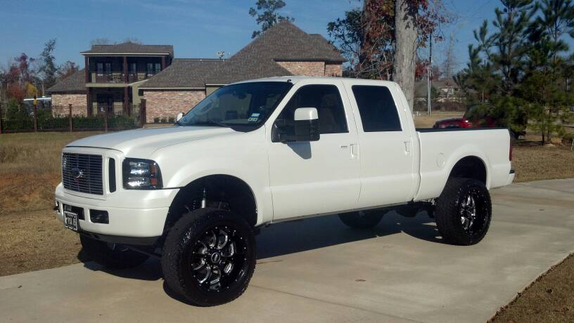

will 22x10.5 rims with 35x12.50 fit with just a 2.5 leveling kit on a 2008 f350

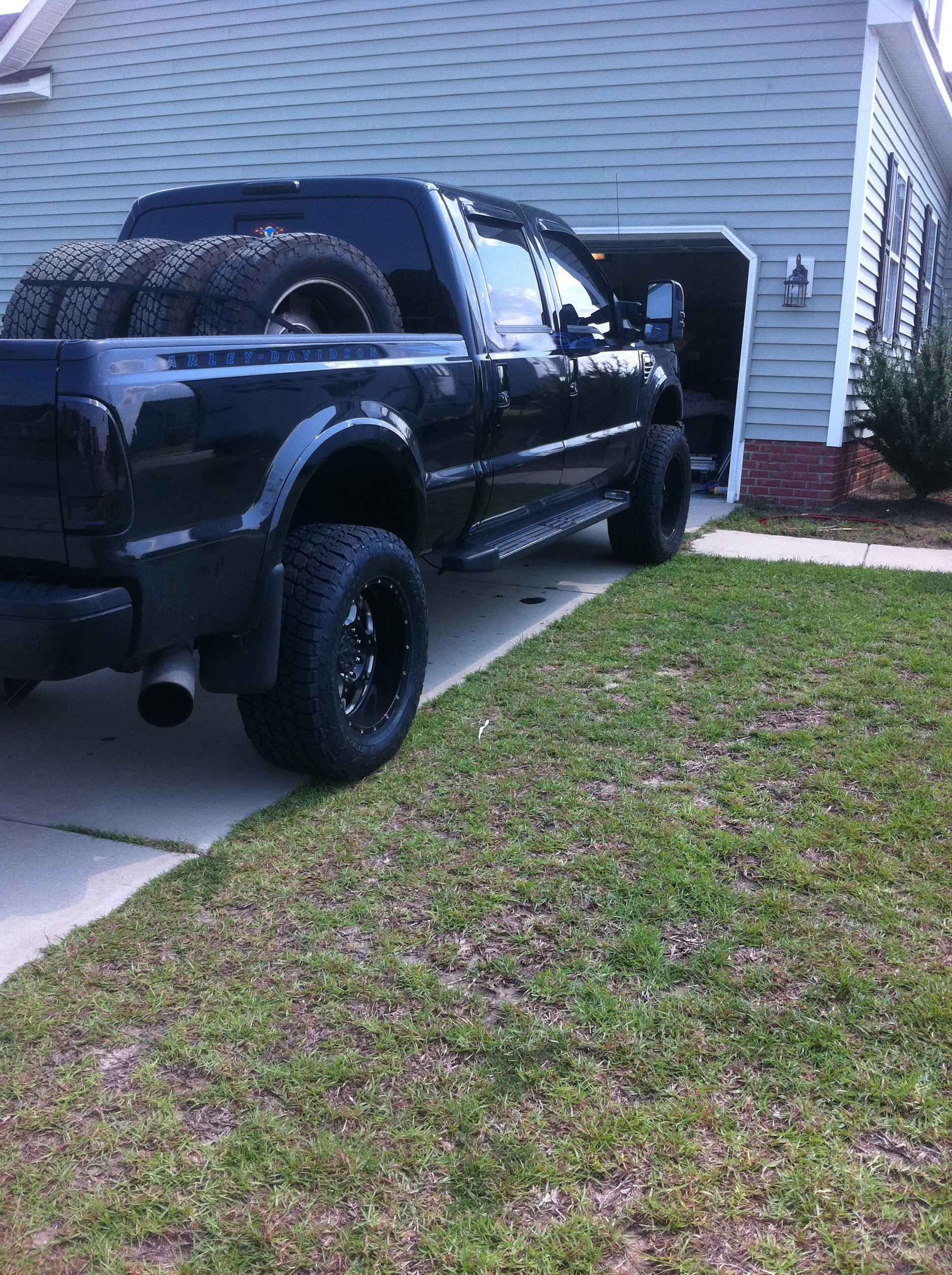

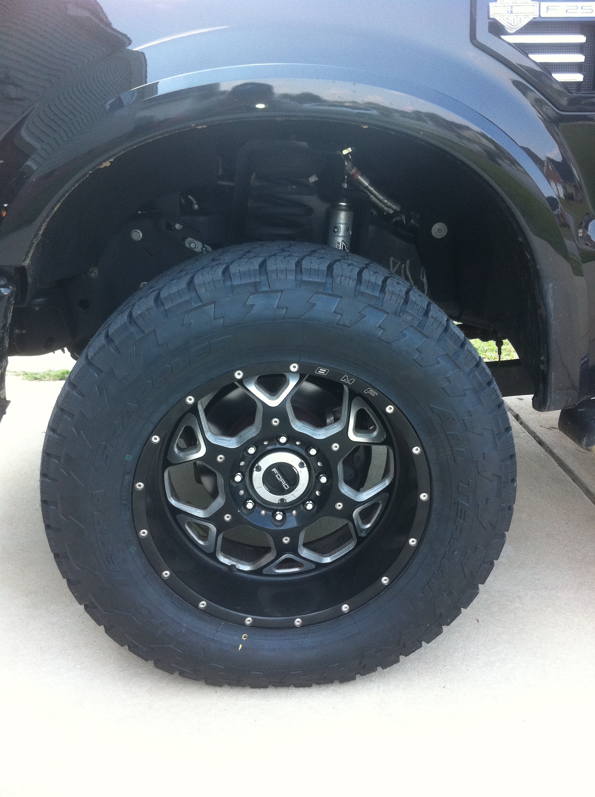

some folks dont like the tires to stick out like that, but i dig it.
20 x 10 BMF SOTA, 4.75 Back Spacing, with 325/60/20. (35.6 inch x 12.9 inch). 2 inch BDS level w 5 inch blocks on the rear.

ya its the cops im mass that dont like it so much i love it 2 how come your not running the center caps on your wheels corbin?

At that point it time, I cracked one, and wanted to get it replaced before I ran 3 and looked ghetto. but, the center caps suck. so ii bought 4 new ones, and still think they suck, so, I dont run them at all, still.
thnking of painting the inside black though, so as to not stick out so much with the silver color...

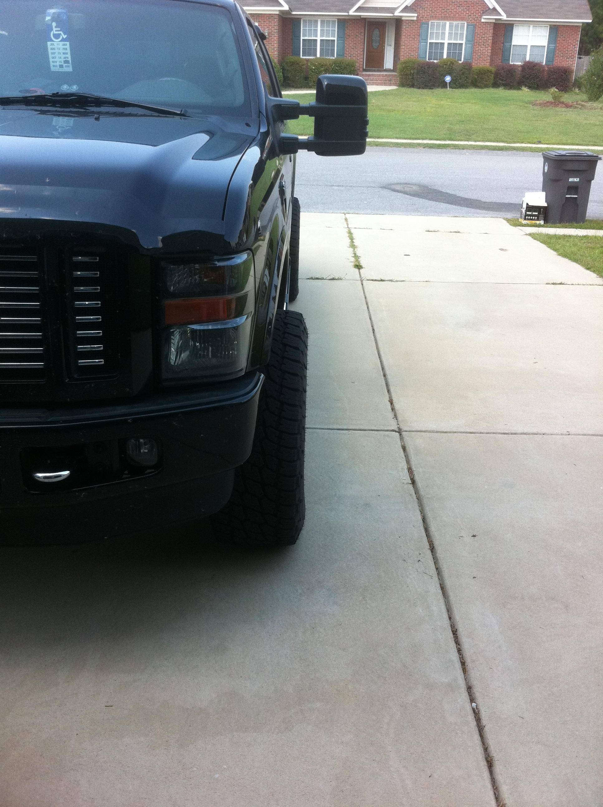

I run a 35x12.5 toyo m/t with bmf sotas that are 20x10 and all I did was pull the inner fender back with a zip tie. I have a 2.5" leveling kit.

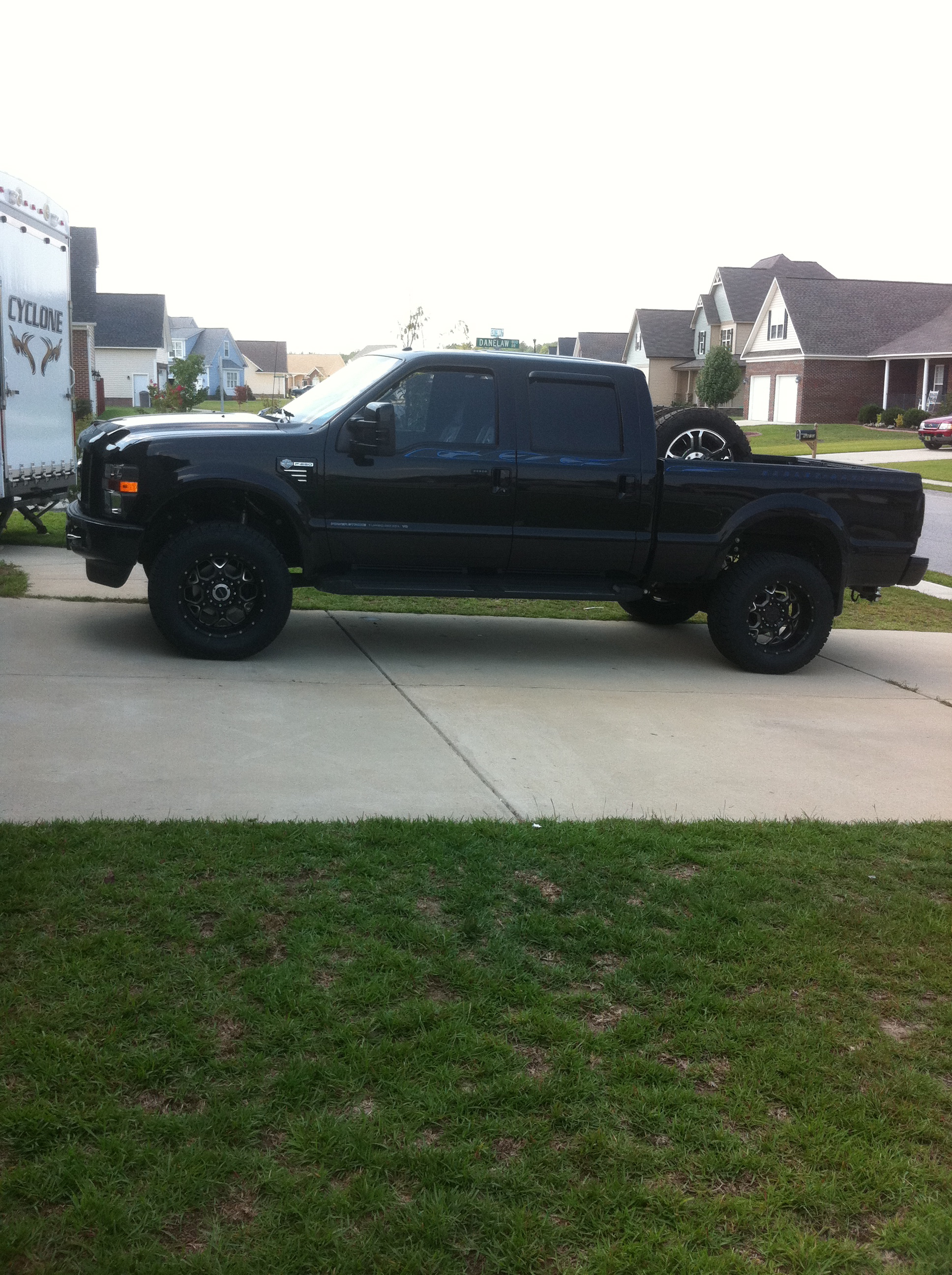

corb can we see some side shots? that looks awesome. im thinking of going back to an AT tire.. wish i woulda done BMF too LOL

These are the best I got. When mine is done at rudy's, i'll be able to post up some more. But it will have a 4 inch lift on it by then, and I am shopping for 37s.
