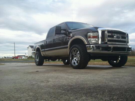

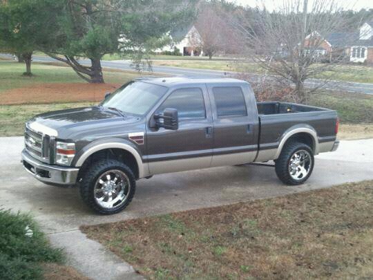

Here's 5.75 backspace 22x10 with 35's.
No lift/level.
Daryl@TDP
1,077
Chesapeake, VA
It will definitely work I wouldn't run that set-up with any more than a leveling kit. I think it would look best with just that, personal preference though.

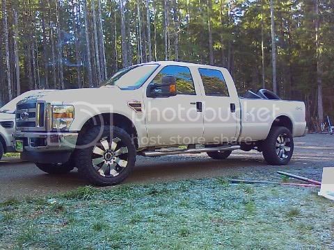

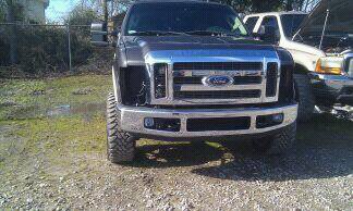

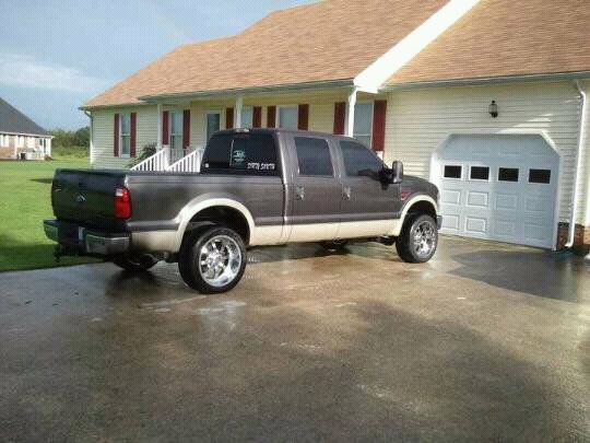

Here are the same wheels with 33s no lift completely stock suspension. Nothing changed no scrub at all.

This is how far they will stick out. Same exact wheel just a 33x12.50. Far from sticking out four inches.
