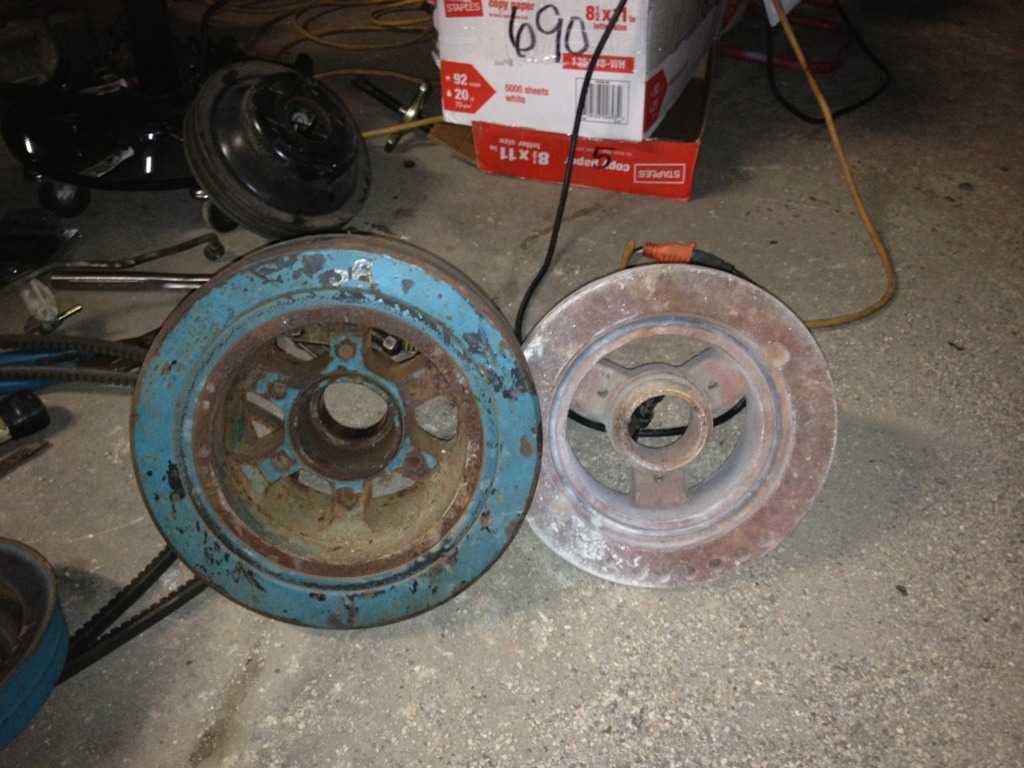

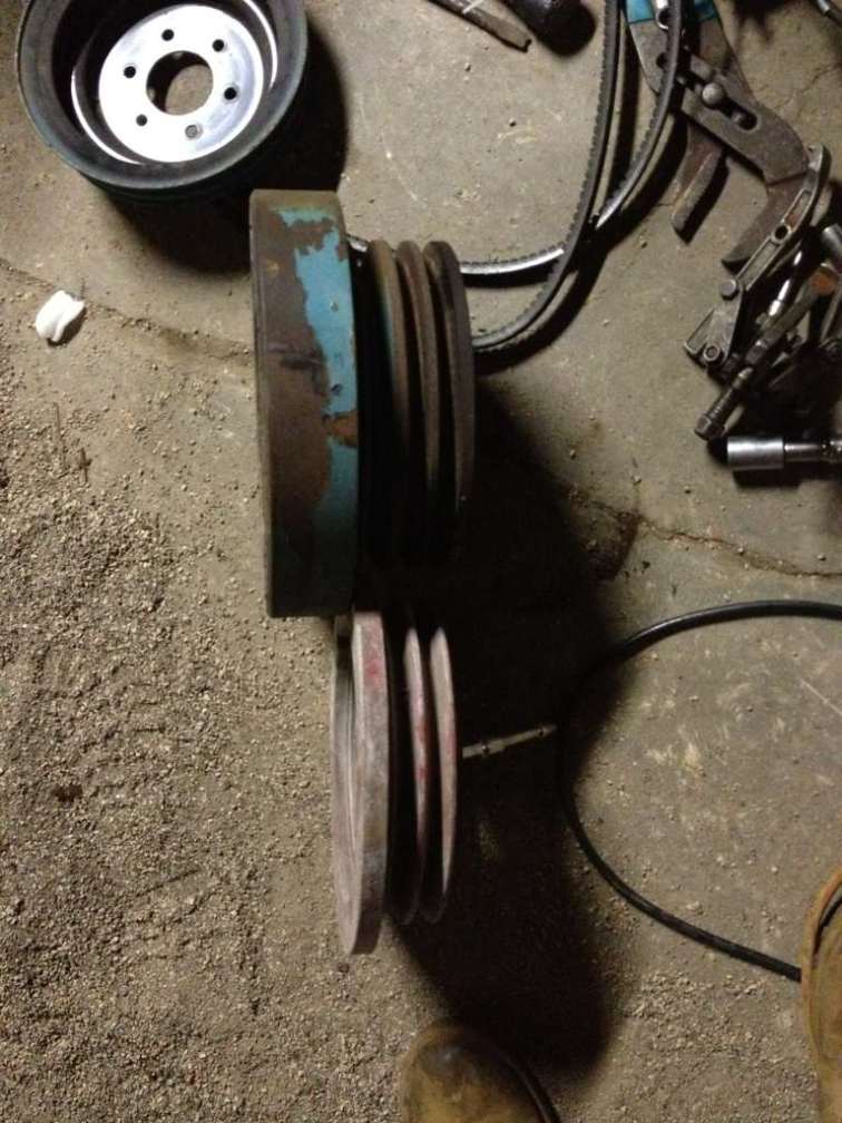

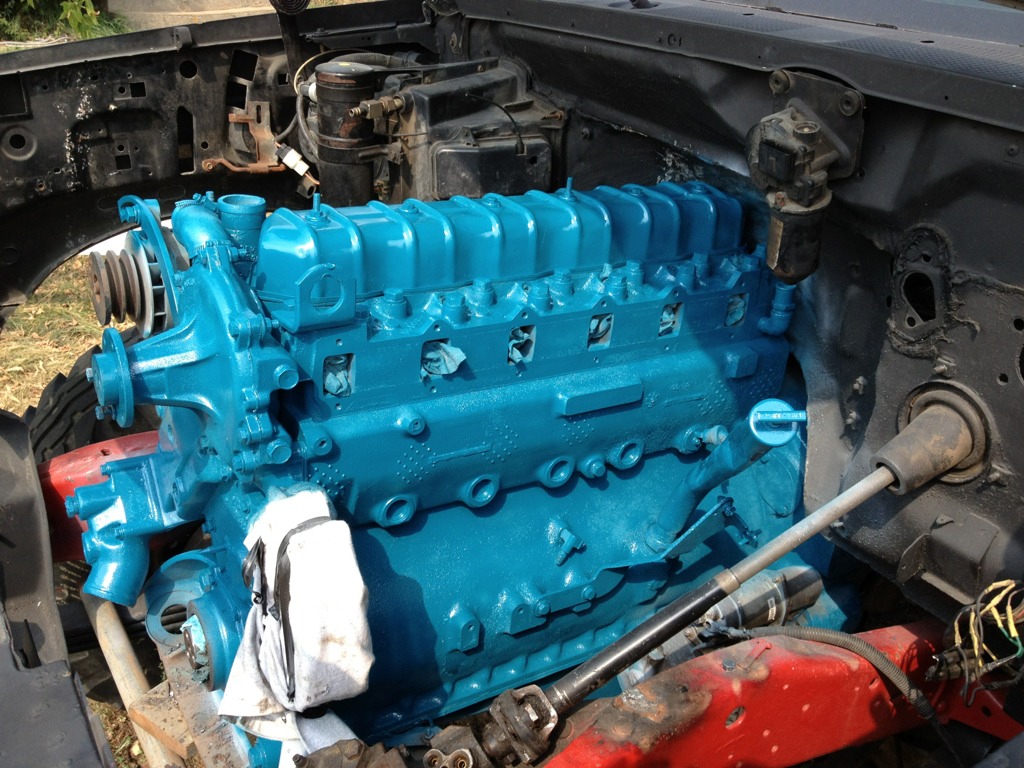

Here's a few more pics. Been working non stop lately so haven't had much time to work on this, but it'll come along
Truck balancer (blue) vs my new agricultural balancer...
The agricultural balancer mounts backwards so the larger ring will be toward the block unlike the truck balancer where the large part was away from the block. Should give me enough clearance to run a 6.0 fan and now I'll be able to change my belts haha

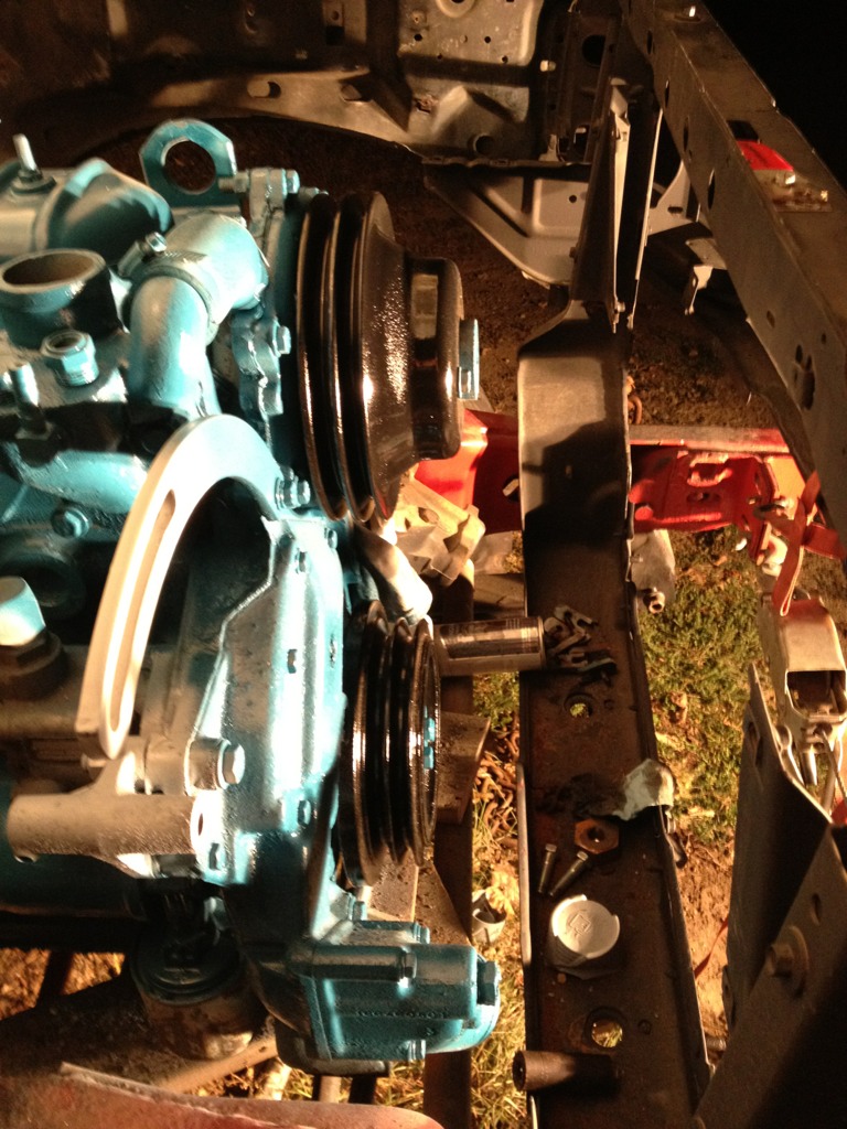

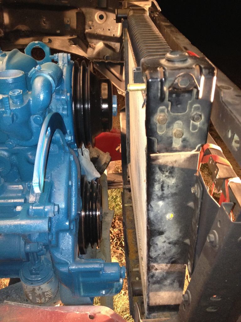

Still need to gain more room at the water pump for the 6.0 fan! Have a few ideas that should give me enough without major revisions

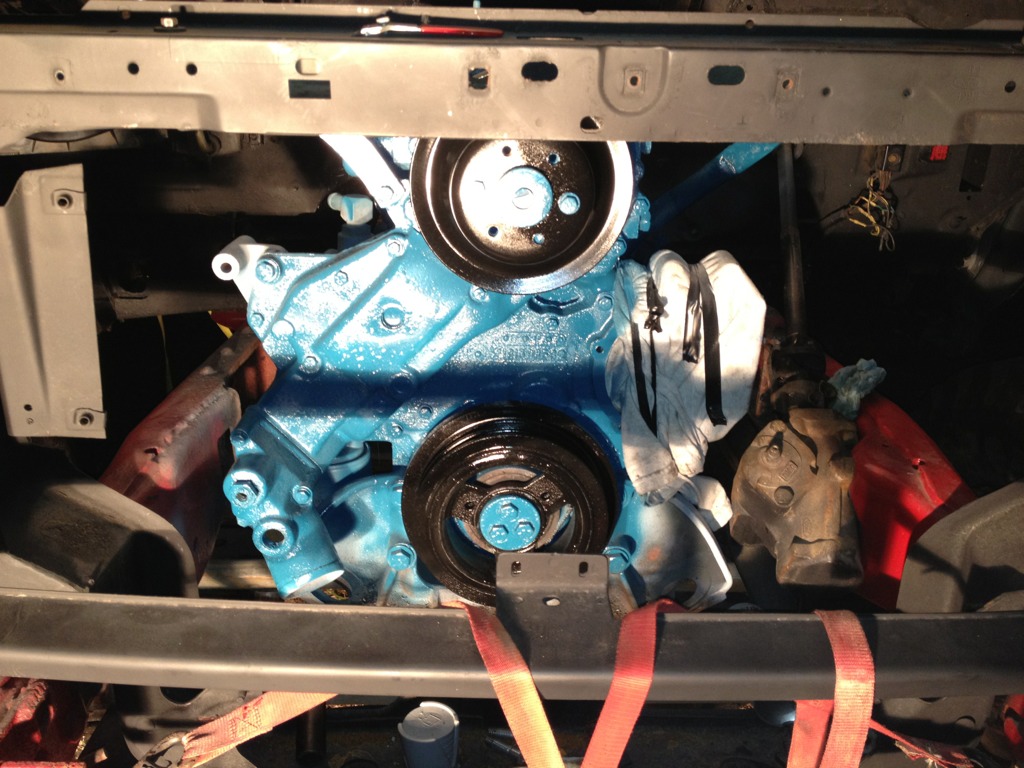

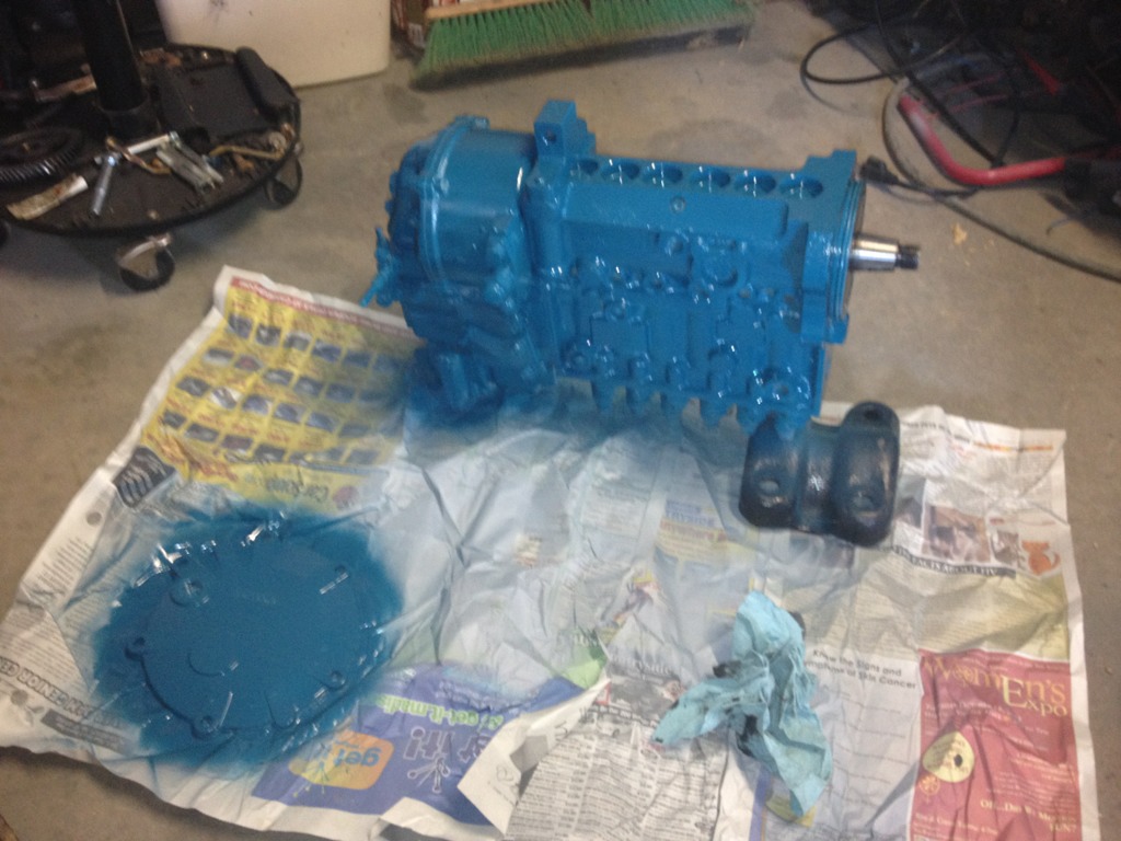

Definately making it known this is ih power, not cummins! The final paint scheme under the hood has been determined! All exhaust side components, injection lines, intake manifold, pulleys and accessories will be black! Intake side of turbos, intercooler piping, intake piping and brackets will be ih blue!
